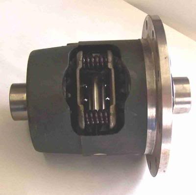

The LSD's for our trucks are the Auburn type, that doesnt look like an Auburn that is why we need a side ways picture, and it has TRAC on the top so I bet its not,

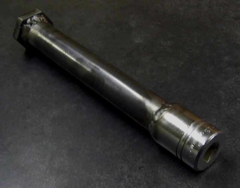

any way some of the tools you will need are dial indictors, with adapters to set pinion depth, you can buy a kit with all you need,
and a side gear adjuster tool, or you can make this tool from a nut welded on a piece of round tubing with a socket welded on the other end, for torque measurements
Bearing Preload Torque and Ring Gear Backlash Adjustment
Use Wrench C-4164, or equivalent, to adjust each threaded adjuster inward until the differential bearing free-play is eliminated. Allow some ring gear backlash (approximately 0.01 in. or 0.25mm) between the ring and pinion gear.
Loosen the right-side, tighten the left-side threaded adjuster. Obtain backlash of 0.003-0.004 (0.076-0.102mm) with each adjuster tightened to 10 ft. lbs. (14 Nm).
Tighten the differential bearing cap bolts. On 9.25" diameter (100 ft. lbs.).
Use Wrench C-4164, or equivalent, to tighten the right-side threaded adjuster to 75 ft. lbs. Continue to tighten the right-side adjuster and seat bearing rollers until the torque remains constant at 75 ft. lbs.
Measure the ring gear backlash. If the backlash is not 0.006-0.008 in., continue increasing the torque at the right-side threaded adjuster until the specified backlash is obtained.
Tighten the left-side threaded adjuster until 75 ft. lbs. is indicated.
This is just the minimum ,I know there is more to it
here is the tool

here is an AUBURN LSD diff
