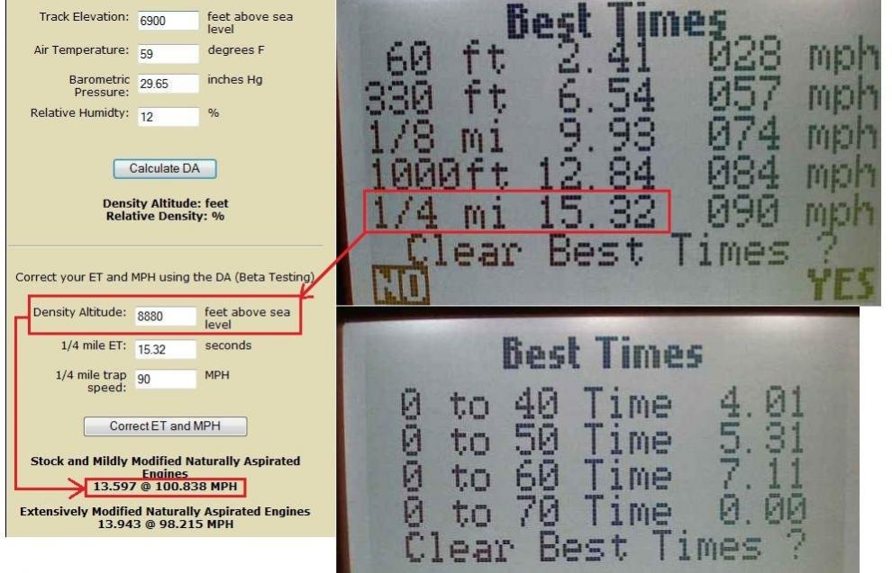

1954 radio, I am running the 13.59 according to my SC logger. I run 15.32 at 7000ft. There is a nifty website that corrects for DA and gives you your equivalent seal level correction. Just enter your temp, altitude and baro and it does the conversion. My corrected time is 13.597 seconds. 4rth gen RCSB Hemi Rams can easily be in the 13's esp with the 3.92 gears. There is one QC I know of that has track slips putting him at 13.9 in the quarter (yes QC). My mods at the time were a K&N drop, SC Tuner with canned 93 tune on 91 gas. Rev limiter @ 6400, 1-2 shift at 6100, 2-3 shift at 6000. I am sure shorty headers and exhaust will get me mid to low 13's (corrected). I would have got an R/T but I need the 4x4 here so I have the extra 300lbs or so.

That's pretty darn good...I didn't realize QC's were running that quick....congrats and thanks for the info!
