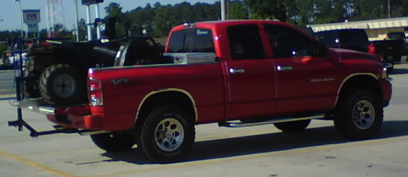

Been totin' around my ATV in my bed for almost five years, with my toolbox, the rear wheels sit right on the end of the tailgate, almost all the weight sits behind the rear axle. No problem yet.
