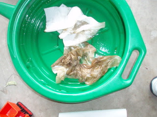

Service done at 29k, fluid was light amber brown, looked pretty clean but anyone out there looking to just remove fluid through the inspection hole would be wise to remove the cover, I did clean the bottom of the pumpkin, there was a little residue from clutch and break in on the magnet at the bottom, no way your gonna remove with out taking cover off, removal of gasket material really easy with 1" scraper and sticky label remover, just make sure you cover gears etc so material does not fall into system.

I have a LSD 3.92, and yes did it my self, been working on cars since 1987 (a beginner mechanic with proper tools can do this), axle took about 1.8 qts and 4 oz of friction additive, all mopar oil used. I would use sythetic if I had a corporate, why not, better product.
