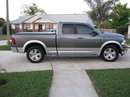

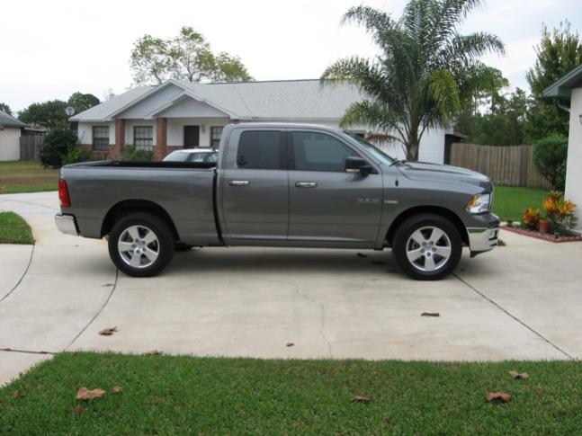

Default Trying this with pics..
Trying to send before/after pics. No drilling as been mentioned. Existing holes and 3M tape, which tends to sag a bit after a while. Very happy with mod and paint job though!
[ATTACH]Has anyone added the Laramie flares and paint?-img_0849a.jpg[/ATTACH]
Attached Thumbnails Has anyone added the Laramie flares and paint?-img_0642a.jpg
