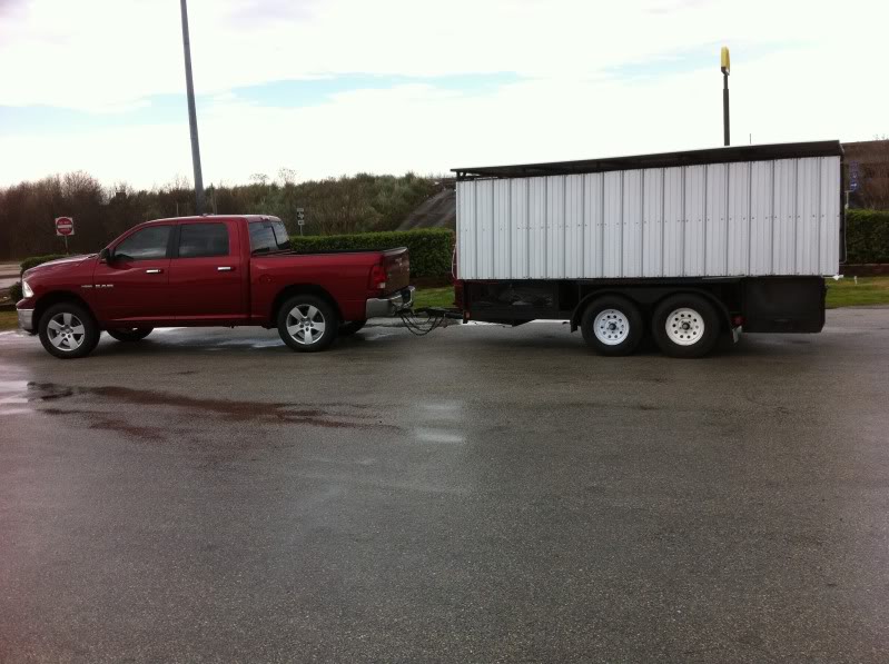

i have the firestones, easy to install and only issue i had was that i cut the hose a tad off going into the bag so it leaked but that was fixed after i thought the bag was busted and firestone sent me another bag free of charge(i now have a spare)
i like that the hoses are not connected and i fill each bag separately
this is with our competition bbq trailer which is 5000 or so pounds and my truck is leveled and bags at 30psi
