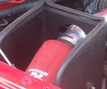

I don't have your brand, but I have a K&N filter on my intake (also oiled) and was noticing my oil was a good bit dirtier at change time and I'm assuming this is because I do a great deal of driving on dusty, dry red clay dirt roads a good 50% of the time when I'm up at the farm in south Georgia.
I went to the pre-filter and saw that my oil was a good bit cleaner from the very first change after going to it.
Mine fits fairly tight, as I have to stretch it over the filter to put it on.
