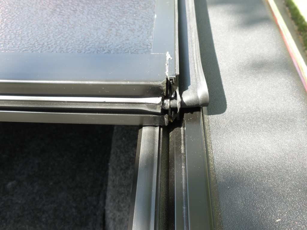

They are usually pretty efficient at communication. Anyway, you may need to use the shims. It depends on whether or not you have water leaks. Position the cover, and look at the gap between the rails and the cover. If the gap is more than say 1/4 inch you need shims. I prefer to use very thin outdoor rubber weatherstripping. Why?? because the shims are plastic, plastic does NOT form a barrier against rain and puddles, so water CAN get in between the shims and the bed,,,and it is possible because the shims also put a tad bit of off camber flex into the rails.. The image below would be an example of the need TO get shims..notice the gap here. Optimally you want to stay under 1/4 inch between the cover and the rails, not too tight that you cant close the cover, but tight enough.
Hope this helps..

Thanks. That's a good idea with the weatherstripping, I think I'll quit asking bakflip about it and pick some up.
