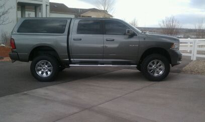

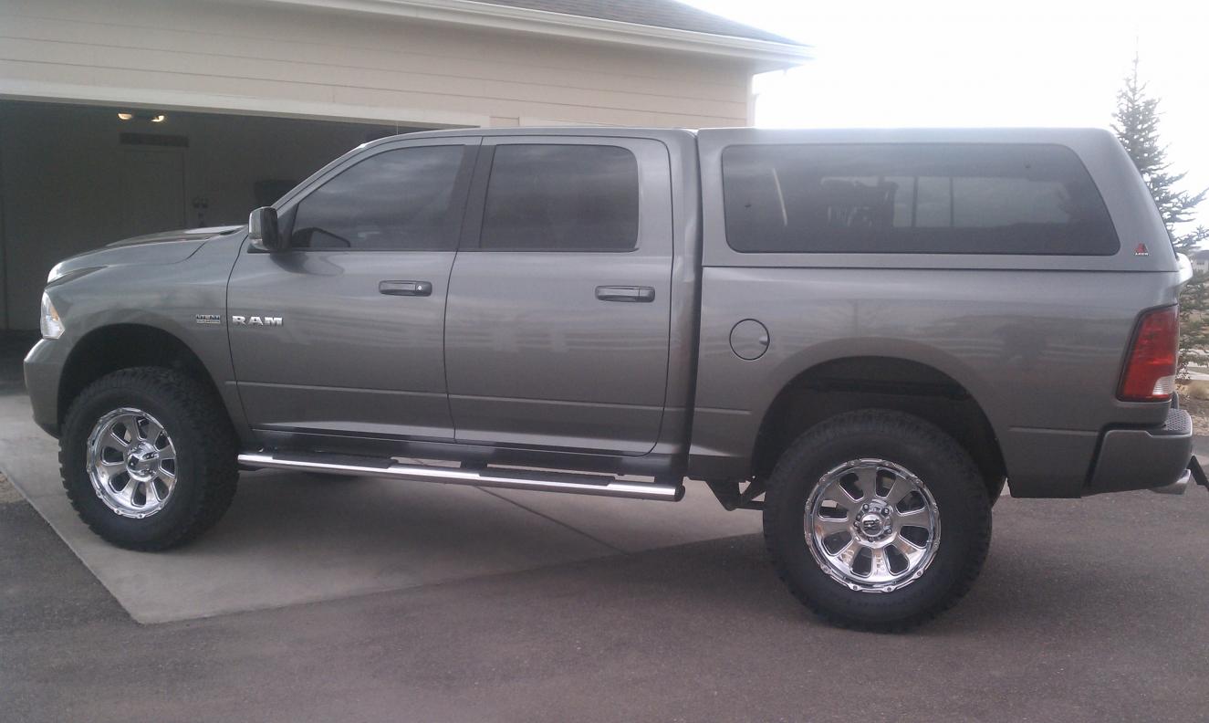

I had 22's with 325 55-22 on my ram with wheel spacers and could not get rid of the wobble. I just put on a set of 20's with 325/60-20's. Problem solved!!! The offset was wrong on the 22's so I needed a wheel spacer to clear. I would suggest that everyone stay away from the spacers if at all possible.

I can check on the offsets. I put the 22's on before i lifted the truck and it rode fine. The lift would not allow the wheels to fit without the spacers. I think the problem was the combination of the spacers and the size of the tire. It was a very heavy combination. I fabbed a steering stabilizer and got the wheels foad forced balanced. This new set up has absolutely no bounce or wobble. I'm so happy!! The tires and wheels had zero problems, it was just the set up. I can sell the wheels and tires to cover the cost since they are in great shape. I tried to upload a pict of the ram before the lift but it won't allow me. I'll show in a new post.
