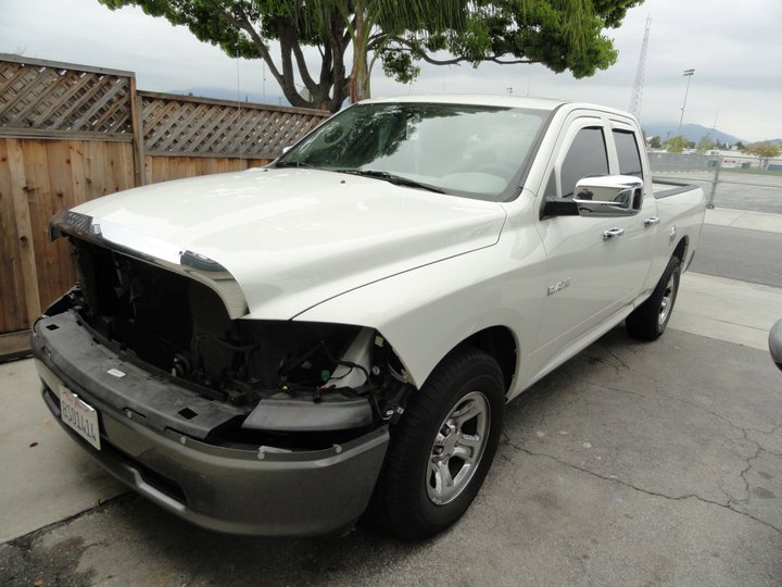

we don't have a cross member (look below).
And Would we have to flash the computer on 4th gen like you would when installing mopar fogs?
Old Apr 14, 2011 | 01:04 PM
Der Dummkopf's Avatar
Der Dummkopf
Joined: Jun 2010
Posts: 106
From: California
I figured this photo was more suitable.
And the plastic there is under the upper fascia.

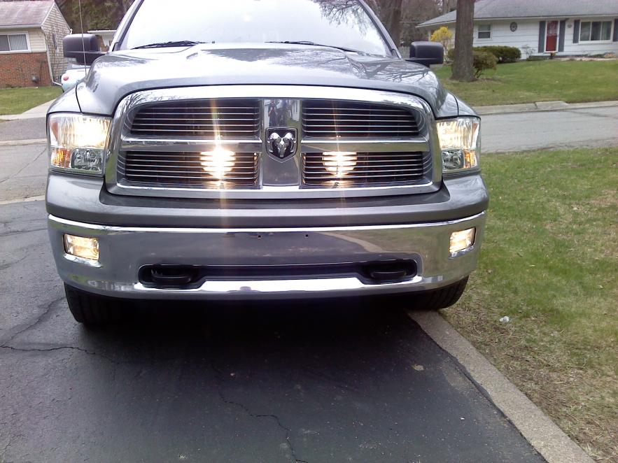

There is a guy in Michigan making brackets for 09's and above.

Nice. I would maybe go with something a little bigger, but it looks good.

I don't like how on that particular truck, the lights are so close together in the grill. They need to be spread out more to look right... like mine haha
