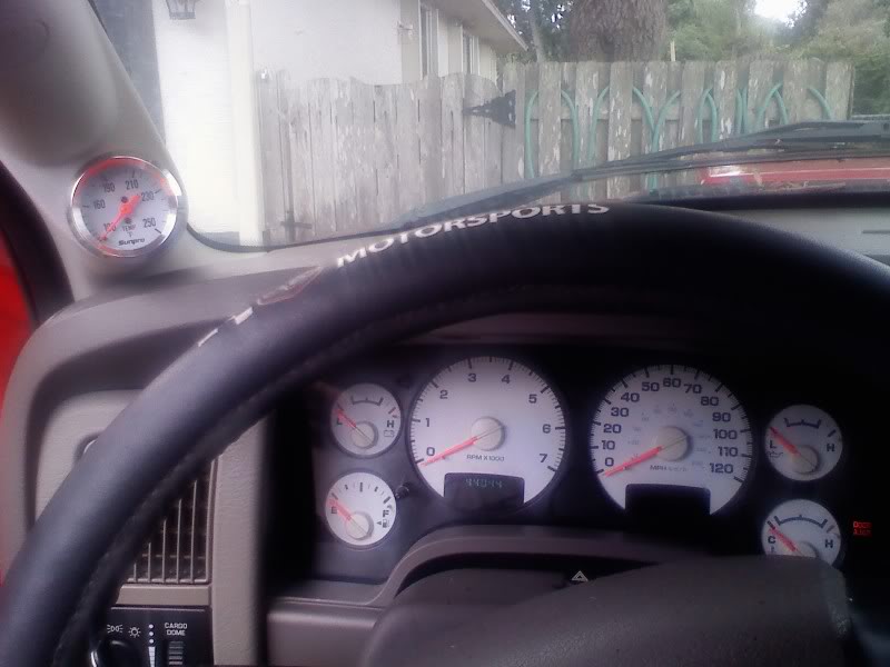

I was gonna say, you SHOULD have one...
E-fan is a good upgrade, you'll see some free'd up ponies and should see a solid 1-2 mpg gain in city driving where a clutch fan is really parasitic.
If you tow, just make sure the fan you get is at least 3000 cfm.
Installing a tranny temp gauge is also never a bad idea, especially if you tow.
