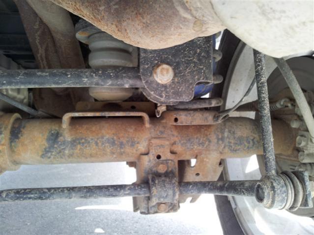

k here goes.... so i buy the kit get it installed. i drive it home it rides like a low rider...go back to shop he removes black spacers 2 or 3 per side..i have roughly about 1/2-3/4 space before they hit. 25 pounds in bags... load my quad sits on the bump stops. my question is that i dont feel the bags are doing anything. here is a picture unloaded with 25psi

here is a crapy pic of my set up

Well the bump stops are gonna be much closer to the axle, I'd say it's normal for them to be sitting on the bump stops when loaded, but your bags should always have pressure on them even when empty.. Did the guy remove the spacers where the bags were, I don't think he should have.
