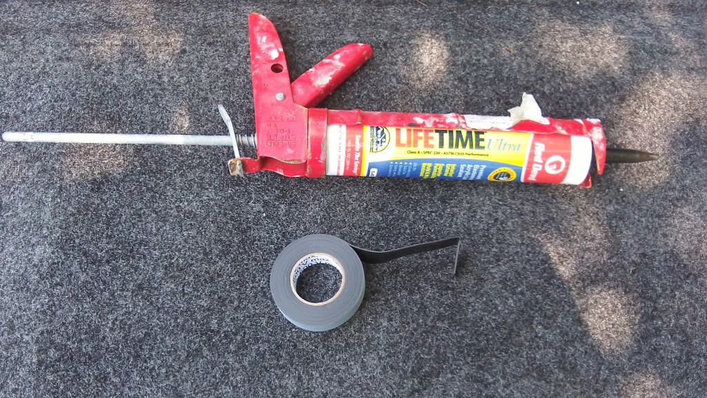

Instead-- I use Electricians Rubber Tape or most commonly known as electrical splicing tape or even temflex (I was an electrician for 5 years).
Clean your rails, and lay the splicing tap on your rail making a tight fit with the top part, close to the existing rubber seal already on it. Cut to fit, and lay the rail down.
*HAVE YOUR WRENCH/SOCKETS READY TO TIGHTEN NOW*
Next, get a tube of BLACK Silicon sealant, and run a bead from the back of the plastic bed cap (By the rear window) all the way to the end of the truck by your tailgate. Then take the rail that has your electrical rubber tape on it, and carefully press it against the bed-cap to form a tight fit. Press it against the rail, and while doing this press down (This will make sure the rail is tight against your bed-cap and resting down right on the bed-cap <you don't want any gaps when looking at the rail from the side of the truck>)
Tighten the middle rail clamp first, and then the two outer ones front and rear.
Place the cover on, and check for a position as needed, also, i used the silicone to run a bead along the top of the bed-cap where the rear foam strip and bed-cap meet to ensure no leakage.
Once its positioned, let it dry for the day or overnight and water test in the morning...Best way to test it spray directly on top, and also take the spray nozzle off, and let puddles accumulate on top of the cover to check for leakage.
Hope this helps out
Materials:
