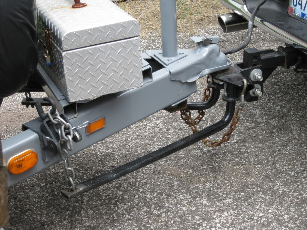

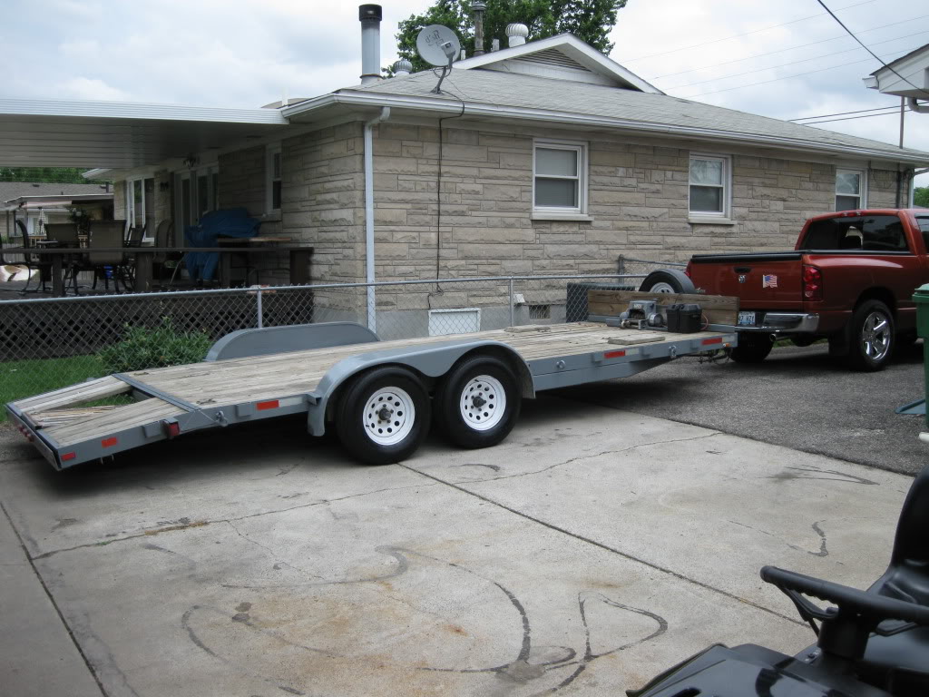

My 08 pulls a 20ft open trailer just fine. Trailer weighs 2700# empty. I've towed around 9000# total with no issues. A weight distribution hitch is a must as is trailer brakes.
