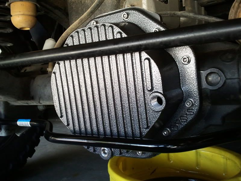

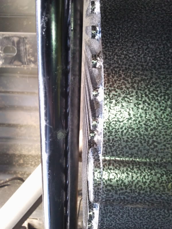

Soo in my head it seems perfectly logical that when you put gears in your truck or upgrade your posi system you put an aftermarket diff cover on to have an increased fluid capacity and be aluminum to dissipate the heat away from your expensive rear end plus having a drain and fill hole makes it way easier to do the fluid dance you have to do after getting new gears. Ive always run MagHytec covers on ALL my trucks but they are soooo expensive a new company just came out called Oasis Diff Cover ODC for short look almost identical for $100 dollars less what a deal rite ? well no one tells you that with an extended cover your track bar hits it !! and there isnt one company that knows it yet i called all of em they all thought i was installing it wrong so i had to take the cover to my local machine shop and get 1/3 of an inch milled off the cooling fins then from the machine work the finish got destroyed so then i brought it to the powdercoat shop and had it custom spayed $180 diff cover + $100 machine shop labor + $50 powdercoat and this is what ya get atleast no one will have the same color haha and it still only clears by 2/32nd of an inch

1/16 of an inch at full lock with the suspension compressed? Or 1/16 as it sits?
