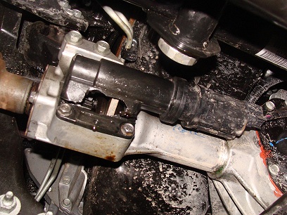

Hi everyone:
I bought my 2011 ram laramie crew cab one and half month ago, took the truck to do my first oil change today , unfortunately, mechanics found out a cover
of a gear box that stays next to the front differential has been broken. The service adviser said is something to do with the 4X4 option. Need to schedule an appointment to fix it.
The thing is , I didn't hear any sound of the chassis was hit on something while i was driving. To me , it looks something exploded from inside of the case.
My question is what is it , what does this thing do? any guess why it got broken. I attached a picture to help to understand.
Many Thanks!!
Attached Thumbnails what is this ? a gearbox next to front differential.-dsc06061a.jpg

Definitely looks like a transfer case. Were you using 4x4 on any dry surfaces?

Front axle disconnect.
x2. It is what connects the 2 halfs of the passenger side shaft together so that you have 4wd. They do this instead of locking hubs on most street vehicles. Looks like you'll be getting a whole new front axle assembly.
What is interesting to me is that it appears that the tube is pulled out of both the housing and the outside of the axle disconnect.

based on age of truck my guess is it was damaged by delivery service while in transit (or coming on/off of trailer) on way to dealer.

Thanks very much for the reply above. I didn't use 4x4 on dry pavement, coz i know the 4x4 low and 4x4 lock option can only be used in snow . Only thing i did is turn the **** to 4x4 auto, which the manual say is ok to do so. don't know if the warranty cover this...

No reason that the warranty shouldn't cover it. Even if you were driving around in 4x4 lock, that would not cause the disconnect actuator to explode.

Update on this issue, the dealer said this broken cover is caused by foreign object hit on it. Warranty won't cover it. Change of this case will be 470 plus tax ! First , i am so mad that this is not cover by warranty. I just have this truck less than 2 months. Second , i didn't notice the truck was hit by a big big rock that can broke the cover like that when was driving it. The noise need to be really loud to cause a damage like this. Since this truck has 500 km on it before i buy it because the dealer transfer this truck from other dealer. I am curious that this damage was already there before i drove it off the lot. I know my argument is kind of weak since i didn't check the bottom ( big lesson) but that's the only possibility that i could think of.

Something hitting it would make sense, except that I would expect to see some damage on the tierod as well. You didn't happen to put a floor jack under the actuator did you?

To your question , no, never.
