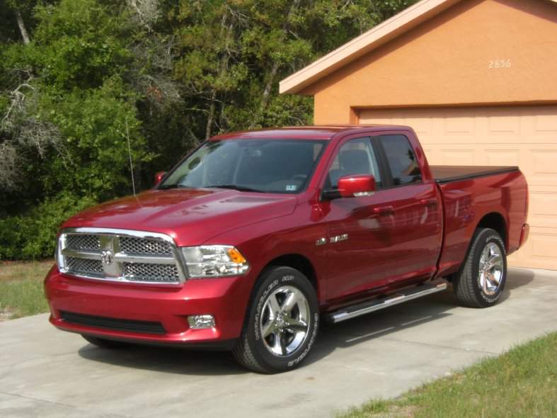

I just installed heated/cooled/memory leather seats in my 2010 SLT Sport x cab. The seats are from a 2011, I got a good deal on them thru ebay. I originally had the sport buckets with drivers power, passenger manual, no heat or cooling. I used a 2009 wiring diagram that I found on the internet. All the wiring was there, including for the passenger power. The heated/cooled seats worked after I bought the lower switch bank for the dash, with the exception of the leds that tell you when they are on. I am building a circuit to drive leds in the dash when the heated/cooled functions are on. The memory function does not work, I think because it needs to communicate with the cluster on the data bus. The cluster needs to tell the memory module the truck is in park to permit it to function. In my free time I plan on getting into the memory module to try to trick it into thinking it is in park. At any rate, it seems that 2009,2010, and 2011 all seem to be nearly identical as far as wiring and compatibility goes.
