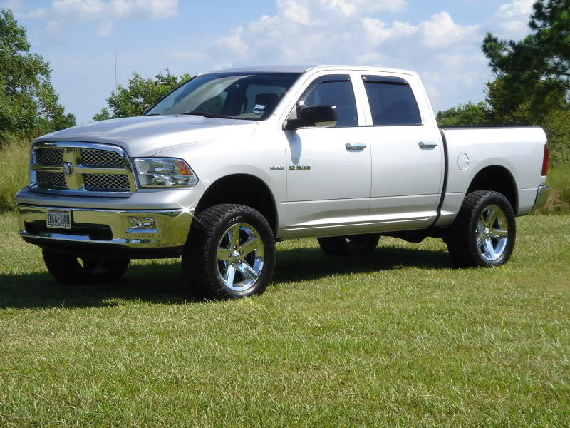

These are my 33-12.50-20's Nittos on stock rims

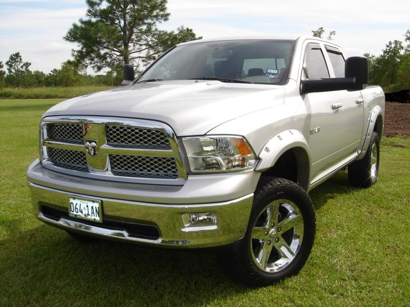

as for the flares, they might say 2.5 but the ones i got are HUGE so big i need more tire sticking out to make it look better I took them back off
