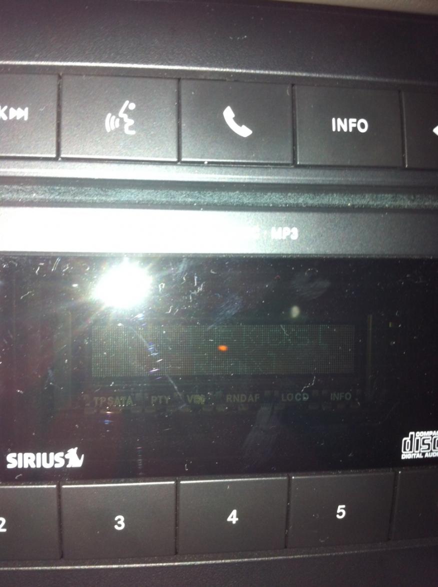

When I attempt to stream any audio, whether a music file or pandora, the result is the same- music played thru speakers sounds like its skipping. When I shut switch source in the iphone from U-Connect to Phone, it plays fine, but the moment I switch back to U Connect same thing.
Originally Posted by jawsdc
Which head unit do you guys have?
I have the 2011 non-NAV U-connect unit:

Old Mar 7, 2012 | 04:45 PM
kpevin's Avatar
kpevin
Joined: Feb 2010
Posts: 296
From: East TN
I havent tried live streaming from Pandora or something like that but for sure streaming the music on the iphone streams perfect. The track back/forward is a little laggy at times but the music plays fine on the road. Even if I leave the phone in the house it will stream off it.
I have a completely different radio though
