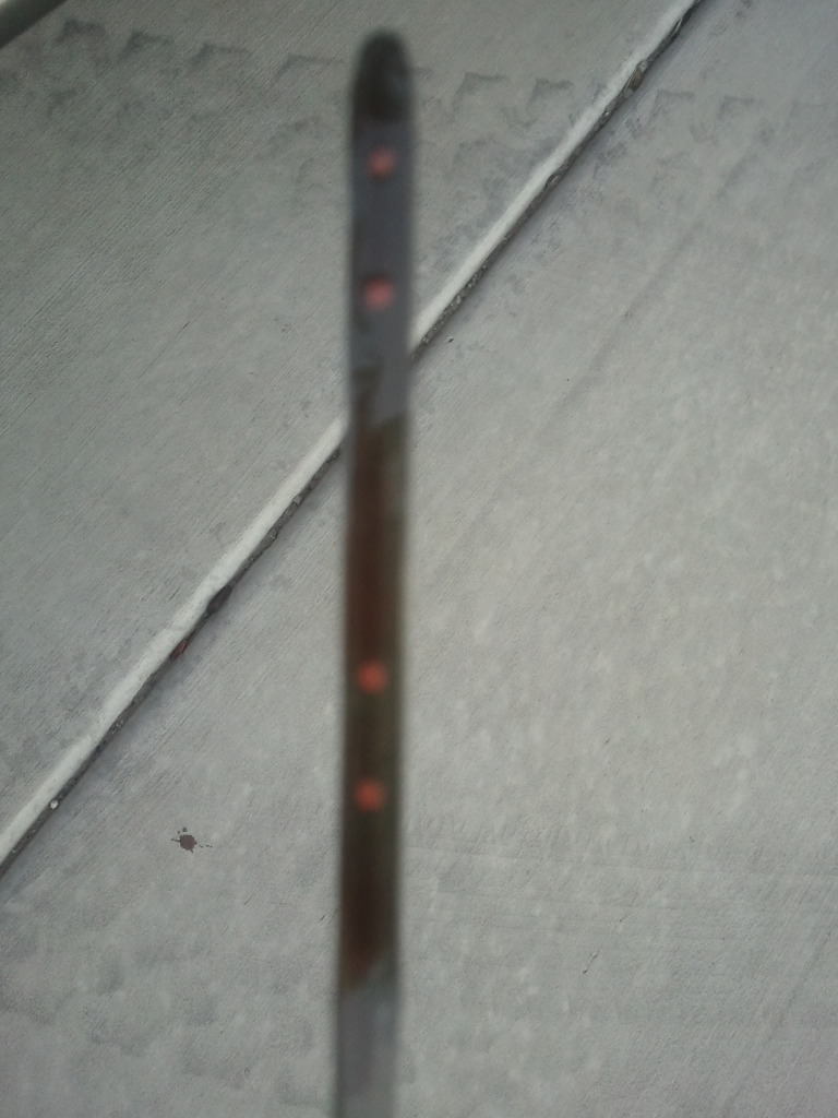

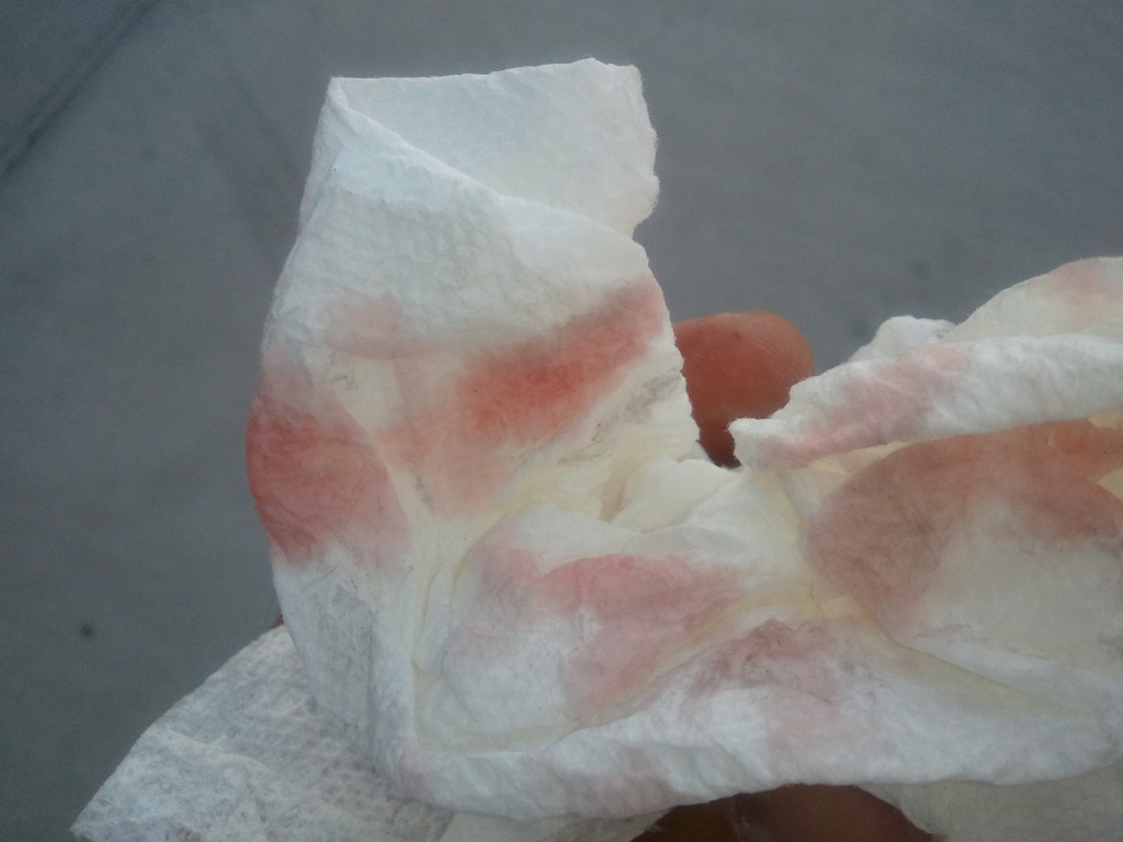

To answer your questions, I do have a four inch lift and run 35 inch tires. I also run a diablo fuel economy tune, I haven't messed with any transmission tuning on it. I'm always monitoring my trans temp while towing. The highest I've seen it is 185, its usually is in the 170s.
I had a chance to check the fluid myself yesterday and to me it looks perfectly fine. What do you think?
If it is fine, I still pretty upset with the service manager saying it needs changing and if it isn't changed now it could affect my warranty. I called Chrysler customer service and they said that there is no way my warranty could be voided unless I changed the fluid past 60k, no matter how hard I drive my truck. But they did say they won't cover a fluid change under warranty at 35k unless an actual problem with the trans was found.

Looks perfectly fine to me.. Any bad smell?

Fliud looks fine. 60k is ONLY with severe usage. the other schedule is what? 100k? If thats the case they can't void or say a thing if not done at 60k either. Now if a service advisor ADVISED to do it at 30k as a preventive maintance not much wrong with that either, especially with big tires,lift and such. I've done the very same thing many times. RECOMEND, not saying its gotta be done. The lift,big tires and most certainly the AFTERMARKET TUNE will and does affect your warranty on the entire drivetrain. The OLD saying is. YOU play,YOU pay!

Looks fine to me. Mine looked like crap at 55K and had to be replaced.
