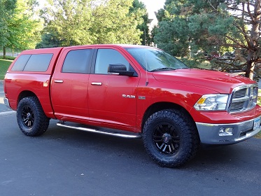

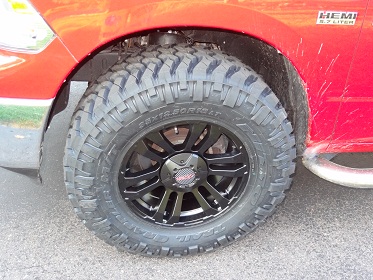

Thanks for the reply, I did pull the trigger and got the 35x12.50x18 Nitto Trail Grapplers and have the Daystar 2.5 leveliing kit with a 1in block in rear. The only rubbing I get is when I crank the wheels all the way going slow - front barely rubs the inside of the wheel well plastic.
only a couple hunfred miles in but love these tires
not sure what tire pressure to have (right now at 40), I do pull a boat once a week (boat & trailer 5K)...........and very little off roading
thanks - I am trying to get my pics to load

Here are my pics
Attached Thumbnails Can I do 35in tires with no rubbing?-dsc00413-copy1.jpg   Can I do 35in tires with no rubbing?-dsc00414-copy.jpg

Sweet setup!! Keep me posted on how you like the Trail Grapplers as you get in to 'em. Hoping my Terra's have a long way to go before I put on new tires, but I'd consider the Trail's ... sure look sharp!
