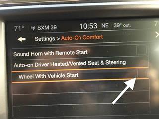

Default Similar issue with 2013 Laramie
In my Uconnect, I see this option....I check the box and in 5 seconds or so later, the box unchecks itself:
Anyone else see this?
I have my climate set to AUTO and I see the seat heat lights and steering wheel heat light come on during auto start but until I get in and press the ON button (where the key would go) - I do not get any heat at all.
Attached Thumbnails Heated Seats not working with Remote Start-1451618_10200376020998221_151537701_n.jpg

That's not normal. Sounds like it's time to go talk with the service dep at the dealer.
Did you ever get anywhere with this hanadarko. No one seems to deem this important. The fact that you check the box and then it goes away is a major problem. I to have this issue.
There is a STAR on this. The dealer has updated software for the seat heater ECM. Once it was flashed (last week) the issue went away and the checkbox stays checked.
I dont have the STAR number but if you run across an issue let me know and I can put u in touch with MY dealer. They got it 1 day before I knew about it.
-HANADARKO
