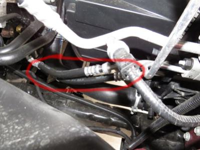

This fix is confirmed by me. No need to crawl underneath. The lines are marked as "transmission". All I did was take out the bolt in the bracket (big phillips or 10 mm) and stick a piece of hard foam between the trans. lines and where is was bolted to. There is enough pressure to keep it held in place. I did not take off the bracket so it would be easier to reinstall if and when Dodge comes out with a fix. I took it for a ride and was pleasantly surprised that the whine had decreased by about 90%. The following pictures are taken from the passenger side.

Funlog- thanks for the pics, I did the fix and like you whine is 95% gone, can't believe this is what it turned out to be but glad it's gone.
