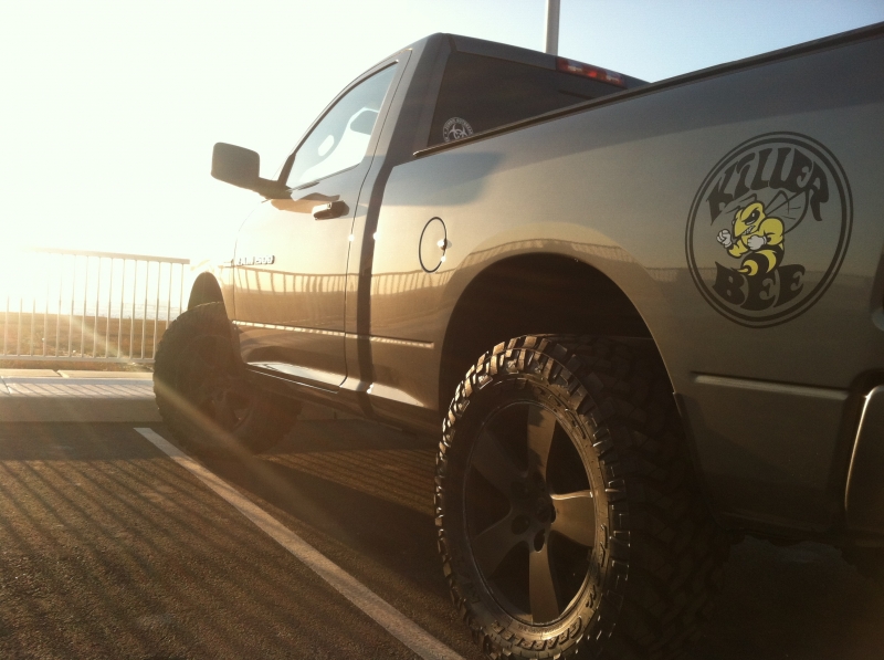

This is a 4x4, but mines a 2wd and I wanna level it. (raisen the front up like a lift) Im hopen the 1 and 1/2 inch is enough to raise it level being a 2wd. I know the above truck is running a rcx 2.5 kit with a 295/65r20. Dunno what it translates to.

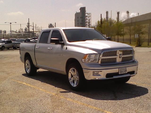

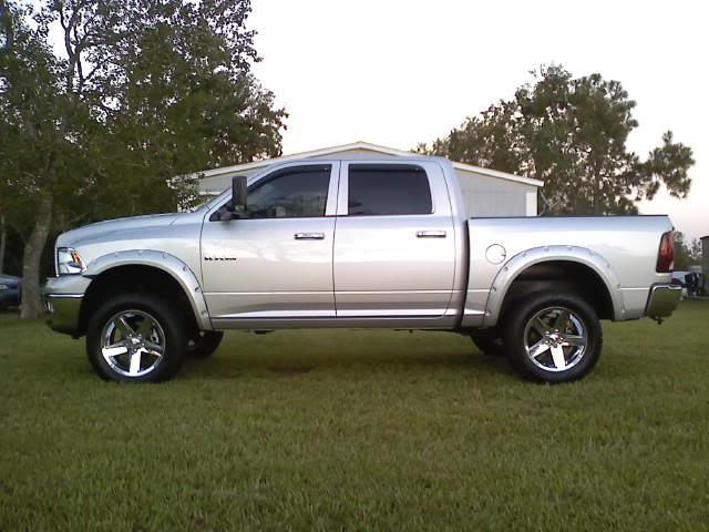

1.5 ON OUR 2wd will not get it level, you need to go at least 2 inches ,but the best is 2.5, performence lifts .com have a spacer that puts it right on the money, 2 inch on mine needed a full tank to make it level, the 2.5 put it right level, and LU229 is right on the money, you will need a front end alignment, after you are done, to get everything back to normal, the ride WILL stiffen a little when you hit REALLY large holes or bumbs, but nothing real bad, the ride is really smooth, on the highway, and most find it has stiffened up the turning, more tight feeling. I have put in 1.5 , 2 , and 2.5 and 3inch, trying out these lifts when I got mine in 09, ended up with 7 inch CST lift....
first got it and 2.5 installed

now
