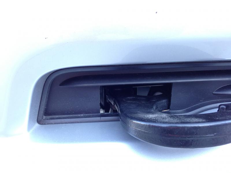

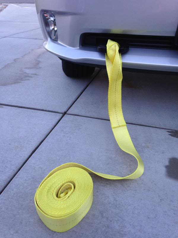

As requested:

The 7,500 lb tow strap (22,500 breaking strength) from Northern Tool fits by the bumper. I definitely wouldn't recommend using any kind of hook/chain on the tow hooks unless you don't care about the paint.

Very good, thank you. That is close. From what I read, they are held by a body mount bolt?
2 existing bolts on the front of the frame, and an additional bolt that goes in to the bottom of the frame. Install is right, but I was able to fit a ratchet and torque wrench in there without removing anything but the bezel that needed to be cut.
