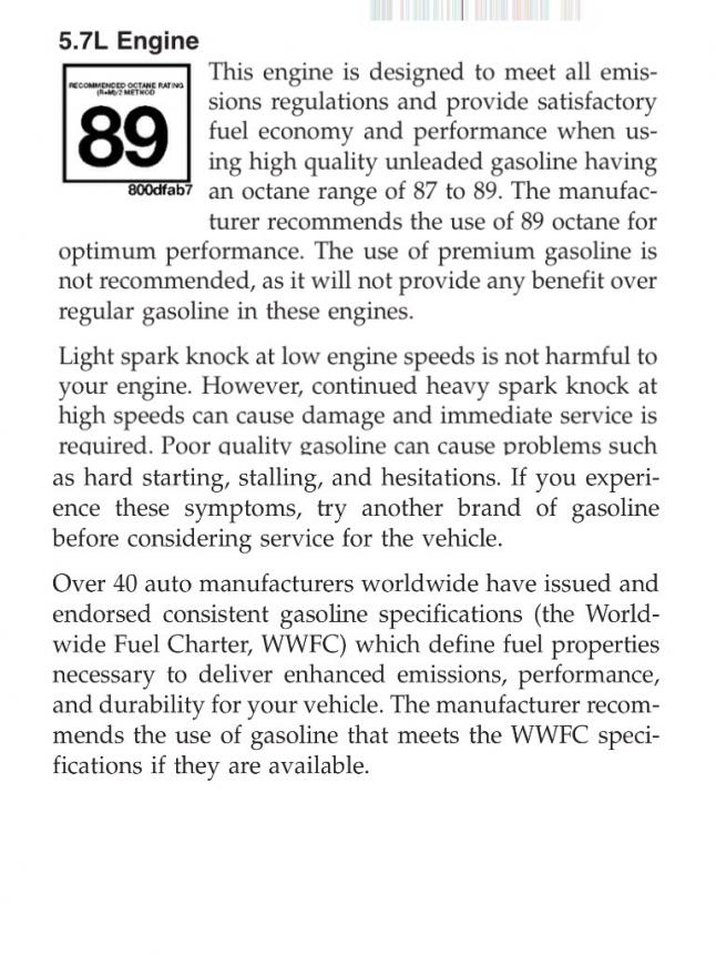

There is a difference between a recommended fuel and required.
I agree, there is a milage increase at 89, especially in the winter months however use of 89 is not a requirement for a hemi.

"The manufacturer recommends the use of 89 octane for optimum performance."
This statement in the manual is a reference to the fact that, while the Hemi will run safely on 87 octane, it is tuned for 89 and the engine will retard timing to safely burn the 87. You will get lower gas mileage due to that if you run 87. Maybe saying that the Hemi 'requires' 89 is too rigid, but that is the normal octane the engine is designed for.
