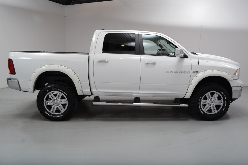

I have a 2011 dodge ram 1500 laramie crew cab that I bought last year with a 4" BDS suspension kit on it. My problem is there is 4 inches of ride height difference from back to front measuring from center of wheel to fender lip. I know BDS has a disclaimer to check the rake of the truck before ordering the kit. I called tech support and they said they don't have a kit that would cause that much rake and that i could put stock coils on and it would level out which doesn't seem right. Does anybody have any experience like this? or suggestions?
I attached a picture

Its not hard to put the stock coils back in just to see if it would be better. The rear OEM ones set pretty high in stock form.
I do agree, you have way to much rake in your picture.
