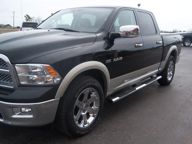

hey Guy i have a 2010 hemi 4x4 laramie all stock factory 63,000 mile
I Have had it shut off on me twice, from a average speed of 45mph slowing down to make a right hand turn seems if im rolling into the turn a little aggressive a little faster than a grandma (nothing like drifting) maybe about 7mph kind of sharp turn, it will just SHUT OFF DEAD cold turkey i have to yank on steering to complete my turn, this could cause a bad accident i shift in to neutral and it cranks right up and coninues down the road, it does not give me any warning lights or beeps or sounds, as if it never happened.
please let me know any ideas before i take it in to get raped by dealer!! thank you
