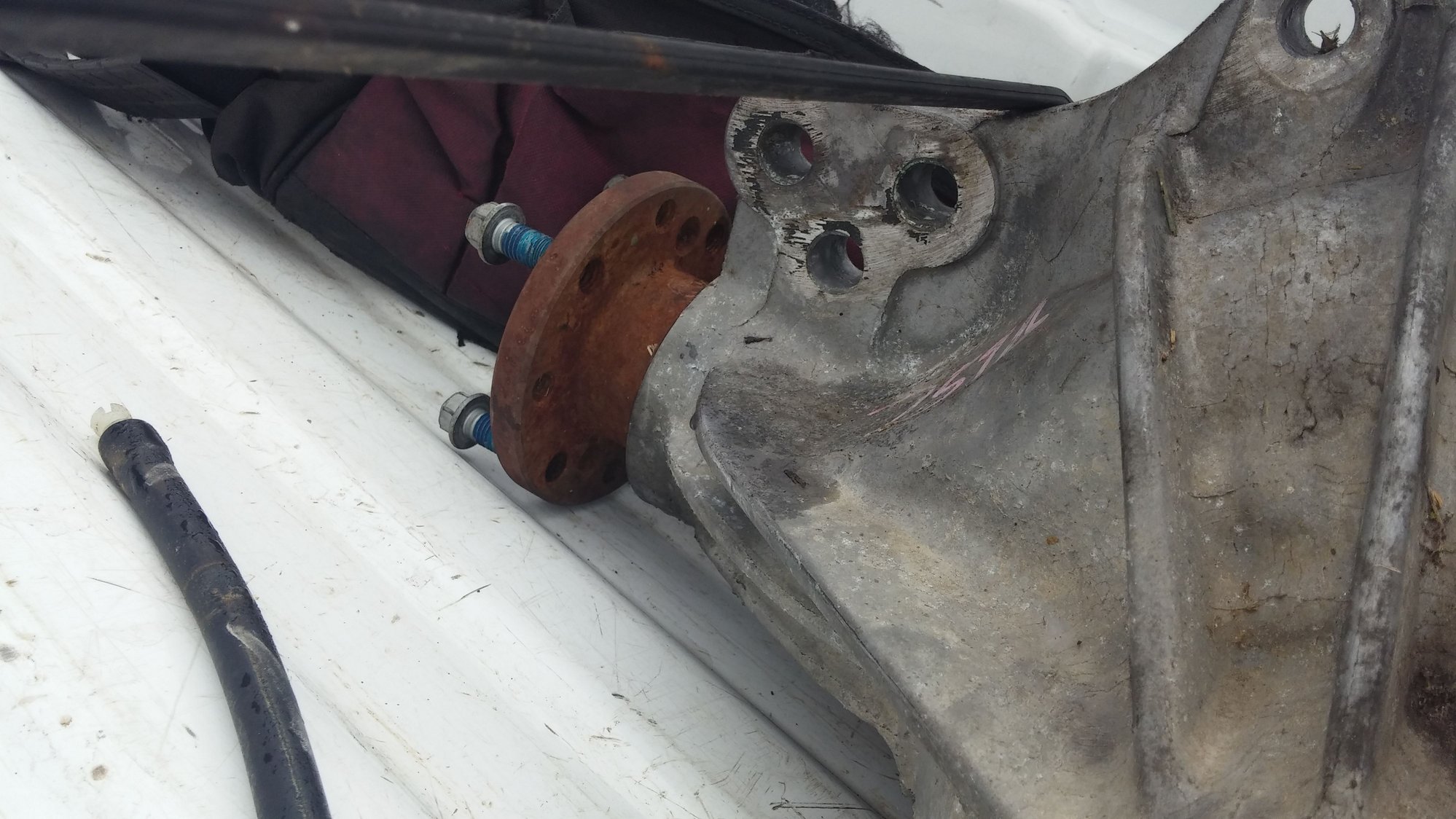

This is the 2009 1500 front diff bracket

Besides these pictures i have no other info
