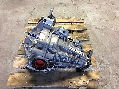

The pics of the 2014 diff i found online, or i would have cracked it open already. But i dont want to open my diff up on my truck yet

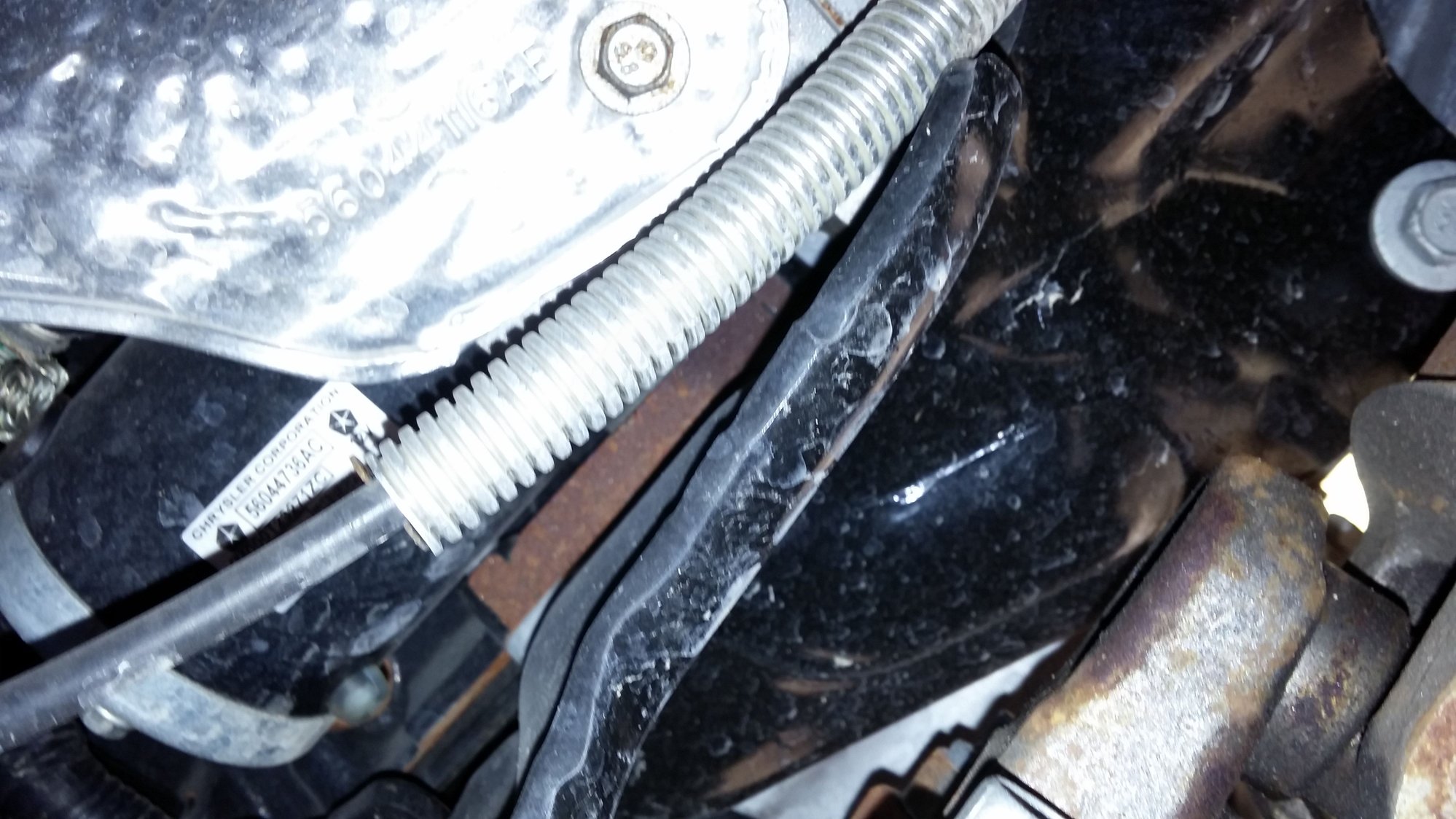

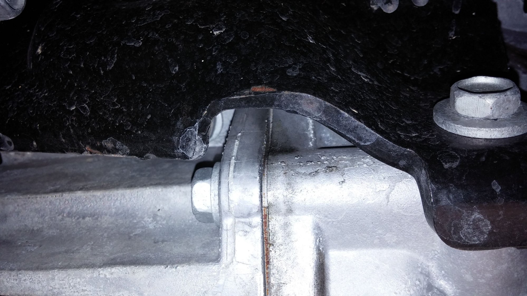

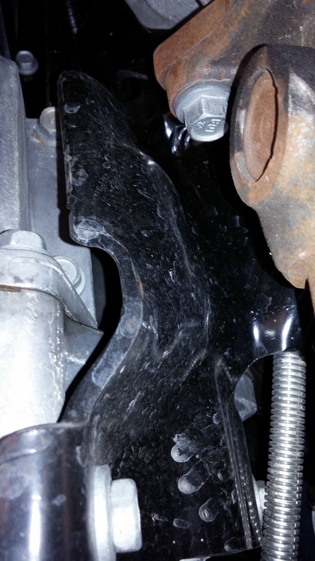

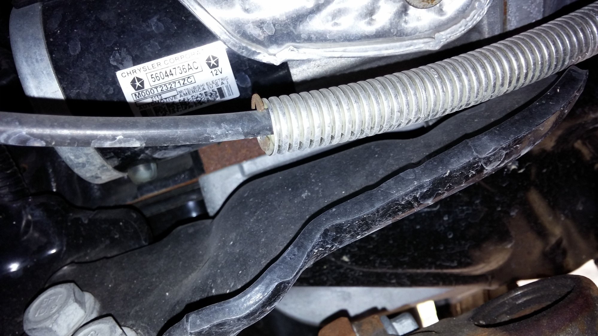

So after looking under my truck at my current front diff the rear metal bracket is just a bracket with the 3 bolts to the rear diff mount to 2 bolts to the side of the engine block. I am going to see if the older models have the different bracket that would work

I was wondering if you'd just be able to swap the bracket for one from an early 4th gen, and have everything bolt right up. Interested to see the results!

Seems like it will, as long as the frame side tie in is the same.
Following this, hoping to see a good solution!
