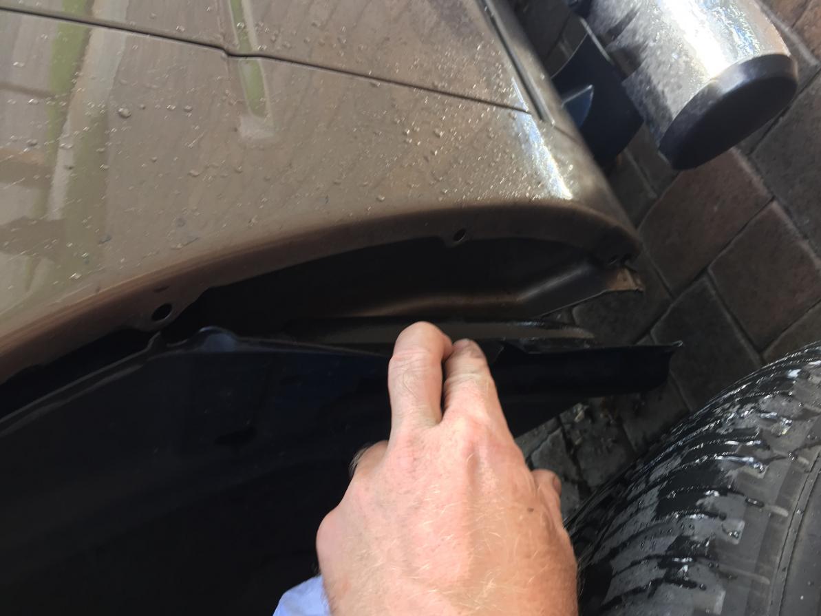

Opened my door today to find swarming black ants, ended finding out that the well between the draft stop in the fender and the plastic fender well was full of leaves, ants and dirt that had fallen down from the top under the hood, inspect yours so at the least you don't get ants or rust!
