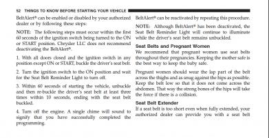

Sorry - these are not "secret" codes. Mine is listed in the Owner and Operation Manual for the 09 Ram. If you do not have the O&A Manual anymore, just Google these Keywords "Disable Seatbelt Reminder <Insert Year, Make, Model of your vehicle here>. The sequence for most Ram Trucks is
1 Get in Truck
2 Buckle Seat Belt
3 Start Truck - wait for seat belt light to go out
4 Within 60 seconds of starting vehicle, unbuckle then buckle your belt 3 times, ending with it buckled (this process (3 times of unbuckle/buckle) must be completed within 10 seconds from the first time you unbuckle.
5 Turn off truck - you will hear one 'ding' to confirm.

Now - the word "permanently" needs definition. Once the procedure shown in the Owners manual is performed, the "BeltMinder" Chime feature is disabled. So, once the procedure is performed and then subsequently you are driving and have your seat belt on, and you then remove your seat belt (while driving), the "BeltMinder" (Chime) will not activate. Same as the chime will not activate if you get in your vehicle, start it and drive away (unbuckled). As shown in the attached pictures, the "BeltMinder" can be reactivated just as it can be deactivated - therefore; it is not a "permanent" alteration to the vehicle.
Note - regardless of the BeltMinder status, the seatbelt light will always come on if the belt is not being worn and the vehicle is in motion above a certain speed (8 MPH I think, but don't quote the speed).
