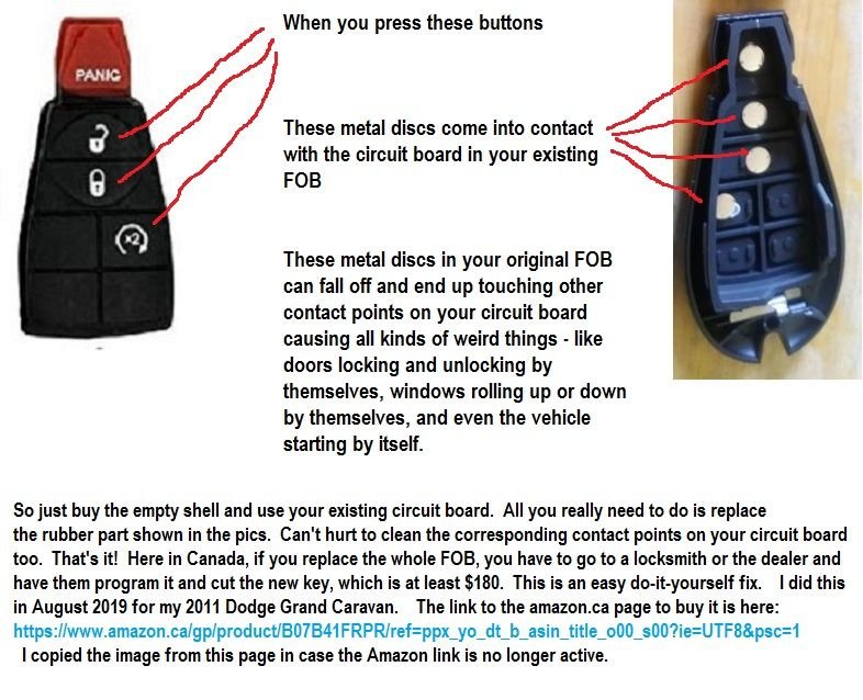

Default 2011 Ram, windows go down mysteriously
I had the same problem with my 2011 Dodge Ram. I opened up the fob and sure enough, the little metal disk for the unlock button was loose. Glued it back in place with super glue. Works fine now. I will see if the super glue connection works in the long run otherwise I would use a dab of silicone since that is flexible.
I found replacement fob casings on Amazon.ca (keylesscanada) for $47 CAD for the pair with blank keys and batteries included. If you choose this option, all you have to do is move the circuit board from the old fob casing to the new. Don't forget to move the keys over as well before you throw out the old casing.
