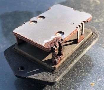

That was it. One of the posts, which I bet is for the 2nd speed was rusted nearly completely through. My guess it is not making any contact to - what I am assuming to be - the resistor plate. I have ordered a new one and should know by end of next week if this resolves the issue.
For posterity, I'll post a couple of pictures of the new/old one to try to help someone out in the future.

Bad blower resistor from 2009 Dodge Ram with manual temperature control.
This is the one I replaced. It cost about $28 for Mopar part from Amazon to replace it.
Repair takes about 1 minute to remove wire and two screws.
