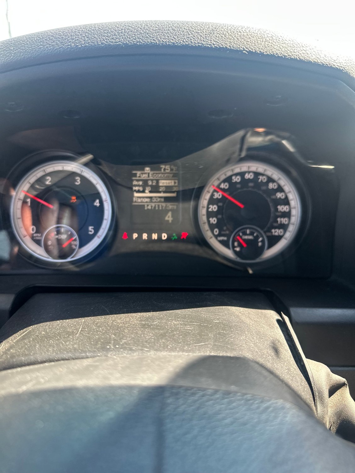

Old Oct 16, 2024 | 03:40 AM
richierich17's Avatar
richierich17
Joined: Oct 2024
Default Cluster goin haywire
Been having the same issues for past 6 months I’ve changed the fuse box and reprogrammed it, I’ve changed the cluster my ac module looked for open wires in harness, changed all my abs sensors this is literally making me wanna burn my truck down, my issue also is when I hit a bump it starts to really go haywire. Any one have any luck finding the cause of this problem.
