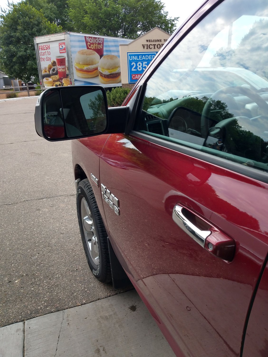

These are the ones I bought
https://www.1aauto.com/2013-16-ram-m...2/i/trmrp00042#
Also picked up a set of the Mopar reinforcement brackets on ebay. Unfortunately they didn't come with the 6 nutcerts and screws so I'll be taking them back off in a week when those get here. The mirrors went on easy, I bolted the brackets on with just the mirrors for now. All the factory function was retained.
FWIW - it does not appear that Mopar actually makes a power folding tow mirror for the 2018, even in the top level trim they are manual folding tow mirrors. I guess they decided that they didn't want to make an extra version of the 2018 style mirrors. The older style mirrors look and fit just fine, so I don't care.
