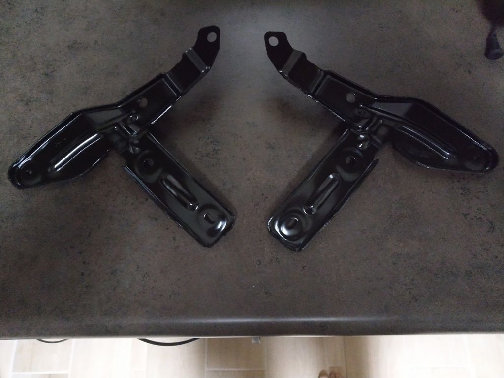

Hardware kit for the reinforcement brackets came yesterday, so I popped the panels back off and installed the 3 nutcerts and screws per door.

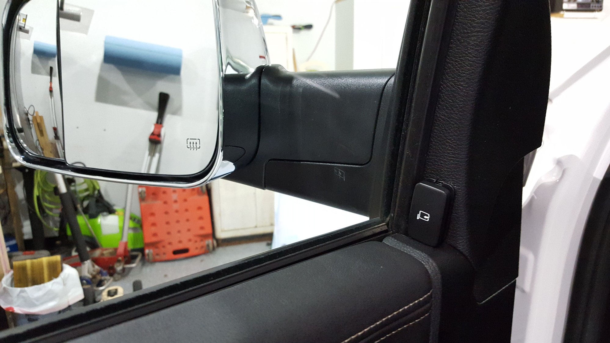

The online instructions for installation are pretty good, although I opted to install my switch in the door since the location they suggested is not available in my 2014. I tapped in to power from the Driver's Door Module with reduced the number of wires I needed to run through the door accordion boot to the cab. The other reason I prefer where I mounted the switch is because if I were to ever go back to manual mirrors I would only need to replace the small little trim piece rather than leaving a hole in the dash or door panel. Here's a photo of where I mounted my switch.
