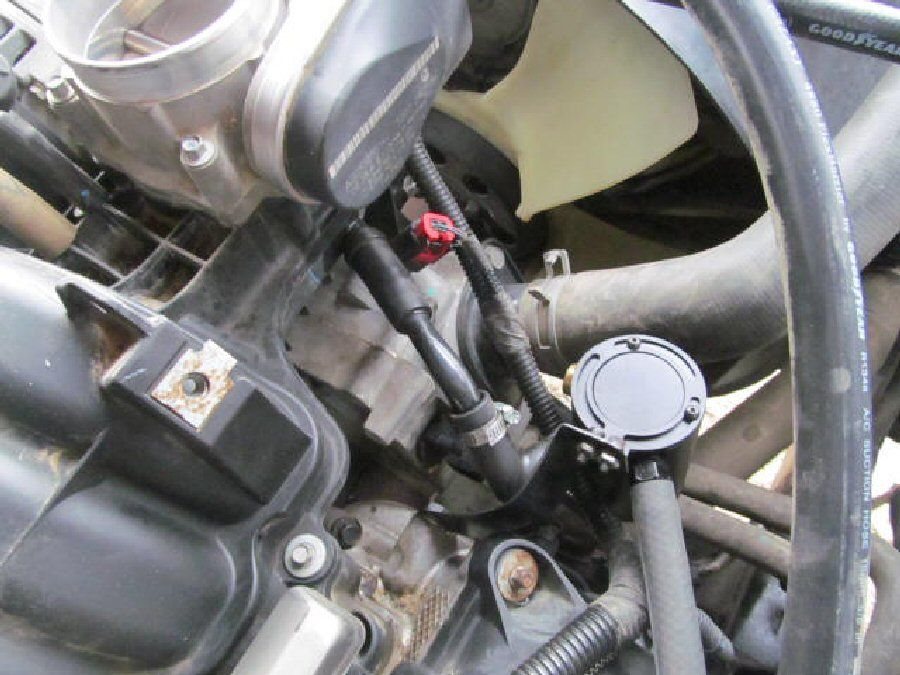

Finally had some time to install the catch can I bought thru ebay yesterday. I made a bracket to bolt to an unused threaded hole in the front of the head. I removed the original plastic tube which runs from the PCV valve and the throttle body & cut off about 5 inches from one end. I used the rubber elbow from the PCV valve end with the short piece of pipe to connect the outlet side of the can to the throttle body. I ran a new piece of hose from the inlet side of the can to the PCV connection. If I had used OE type clamps, it would look like the factory did it.
