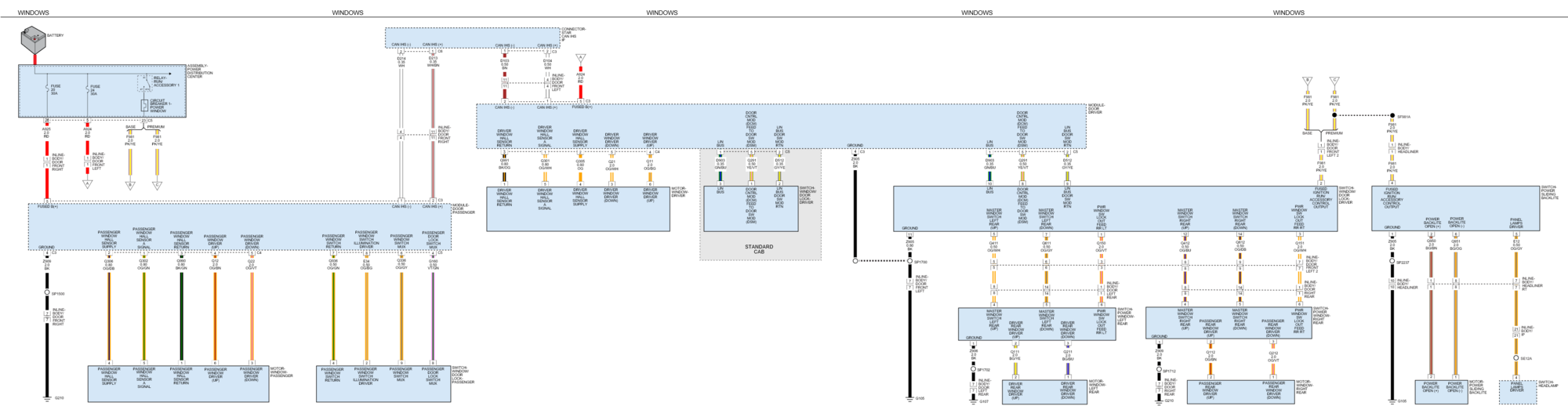

So I know this post has been dead for a little bit but I've done so much research that I figured if anyone was curious, they can find it here. At this point I'm mainly trying it because so many people say it can't be done. Here's what I know so far:
  • The interior panels for a manual window truck and a power are obviously different. If you wanted to cut switches into the manual panels the motors would fit but there's not a smooth place for the panels. The good new is the panels and doors for the 1500, 2500, and 3500 are all the same, the bad news is the regular cab and the crew cab is different, and the regular cab is VERY hard to find, although every now and then they pop up on eBay.
  • The computer has to be flashed by the dealer, and they tell me this is very tough to get right.
  • @HeyYou was correct when he said the windows are all controlled by the modules in the doors, as are the mirrors and door locks, but after getting the correct part numbers from the dealer, they also turn up on eBay from time to time.
  • The TIPM for a truck with power windows is different for a truck without them, that said, the fuses and relays for the windows are in the box, so I'm not sure if that absolutely has to be replaced.
  • You obviously have to run harnesses through the doors, but you also have to run harnesses through the hood to. Now I've found a wiring schematic somewhere, which Ill attach. So maybe instead of running a new harness through the truck I'll just run a few more wires since it's all the same connectors just spaces left blank.
  • I could use the panels and switches and hot wire it into the truck, but there are something called hall sensors in the motors that talk to the door modules so something laying up against the switch doesn't strip out the motors, that is also important for the auto up and down switches, or like a dog or kid getting their head stuck in the window (ya never know). This is where my Arduino might come in, but that's pretty much a worst case scenario I expect that to be pretty hard.
  • Since this truck was stripped down I got it for about $12k under list. I found another similar truck with power windows for an additional $2,500, but it was half way across the state. That said, I'm expecting this project to run my about $1,500 for windows and locks, maybe mirrors if it works. Hoping to recoup some of my losses by selling the manual parts to the truck (lemme know if anyone needs panels)
  • Attached are some pictures of what I have so far
    I got these for $450 for the set on Ebay
    These are the part numbers for the PDC, an Aux PDC, and the harnesses that I may or may not need
    This is a schemactic I've found on the internet
