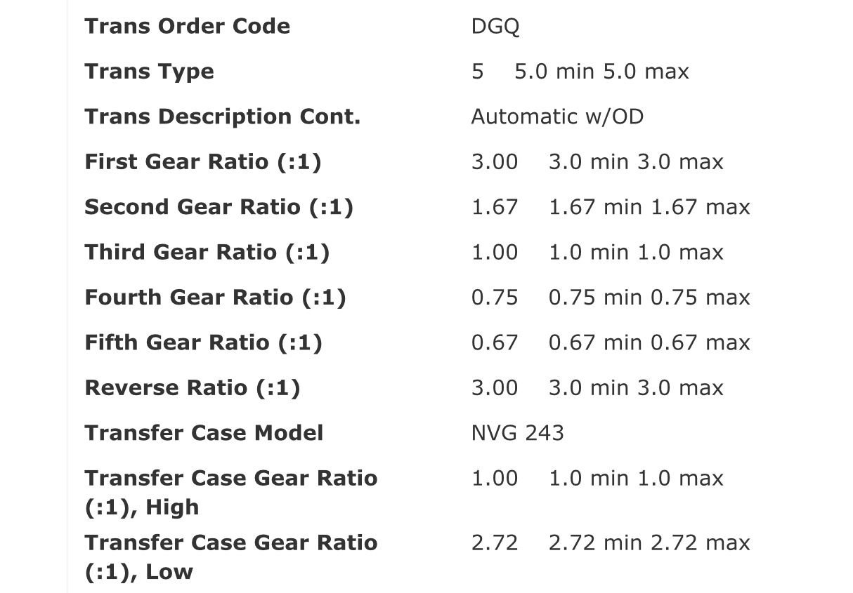

I’m not sure what transmission it is. I attached a pic of the specs from the vin#
115,100 miles when it went in. 117,750 now.

difficult to pick out the noise on the video that you hear from the regular road noise... I will describe my noise again as a shudder ( low pitched noise) that seemed very close to the shudder you would hear when driving on road edge rumble stripes... the road rumble strips would be MUCH louder, then what the tranny did, but about the same kind of noise only lower volume. It was not a tinny/metal clang noise more like a low rumble.
I actually never heard the noise until going freeway speed, like 60+ and it only happened when I let off the gas. If I would give it gas again the noise stopped. As long as I was on the pedal it did not make noise. This was back in 2000 as I recall, on a 1994 Dodge van 250, with 3 speed and OD. At the time I had about 100K on it, but I towed a boat back then all the time. Looks like your have 4 speed with OD which I believe was the next tranny out.
If that is what you hear/feel then again I will point to the pint bottle of friction modifier that was added to my newly filled/flushed tranny. It took about 1,000 miles or so as I recall before I had the shudder noise after having new fluid put in, but after hearing it a few times only on freeway steady speed driving I finally went to the tranny shop... as soon as I described the noise the fella came out of the shop with this maybe even 1/2 pint bottle of liquid and added it to the tranny. He said give this a day or so of driving and get back to me. That was my daily driver, and It took me a few days to get to the interstate, but when I did the noise was gone.
