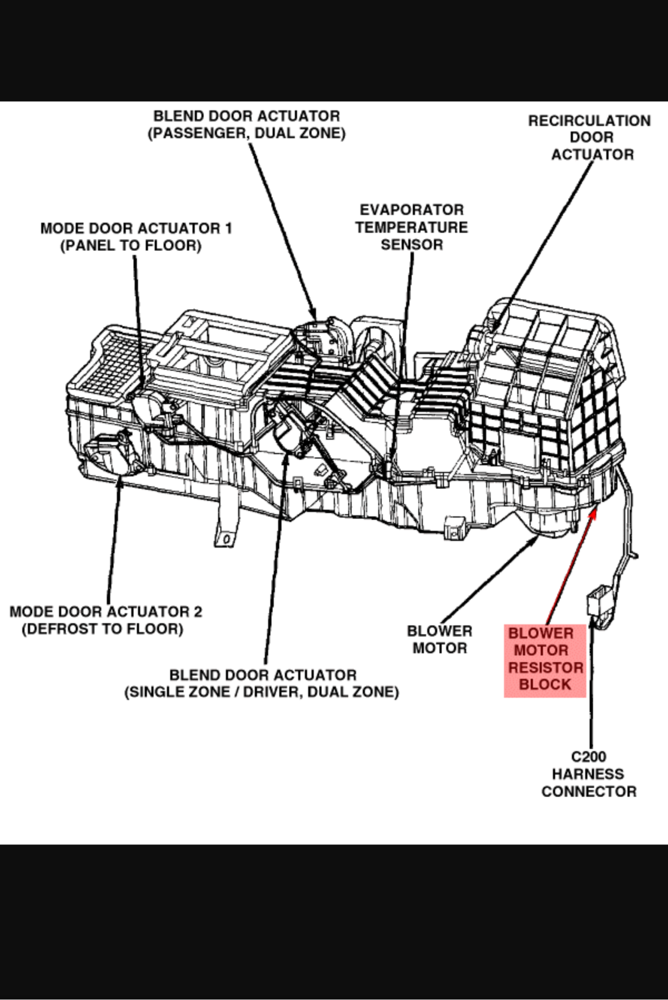

Old Jan 30, 2020 | 05:50 PM
TrueDogman's Avatar
TrueDogman
Joined: Mar 2012
Posts: 597
Likes: 33
This MAYBE similar ?
ok... so passenger dual zone... great....HOW THE **** DO I GET BACK THERE!?

Old Jan 30, 2020 | 10:26 PM
TrueDogman's Avatar
TrueDogman
Joined: Mar 2012
Posts: 597
Likes: 33
That pic was a quick google search for 2010 Ram. Please ensure yours appears similar before you go getting tennis elbow in 3 different elbows..
