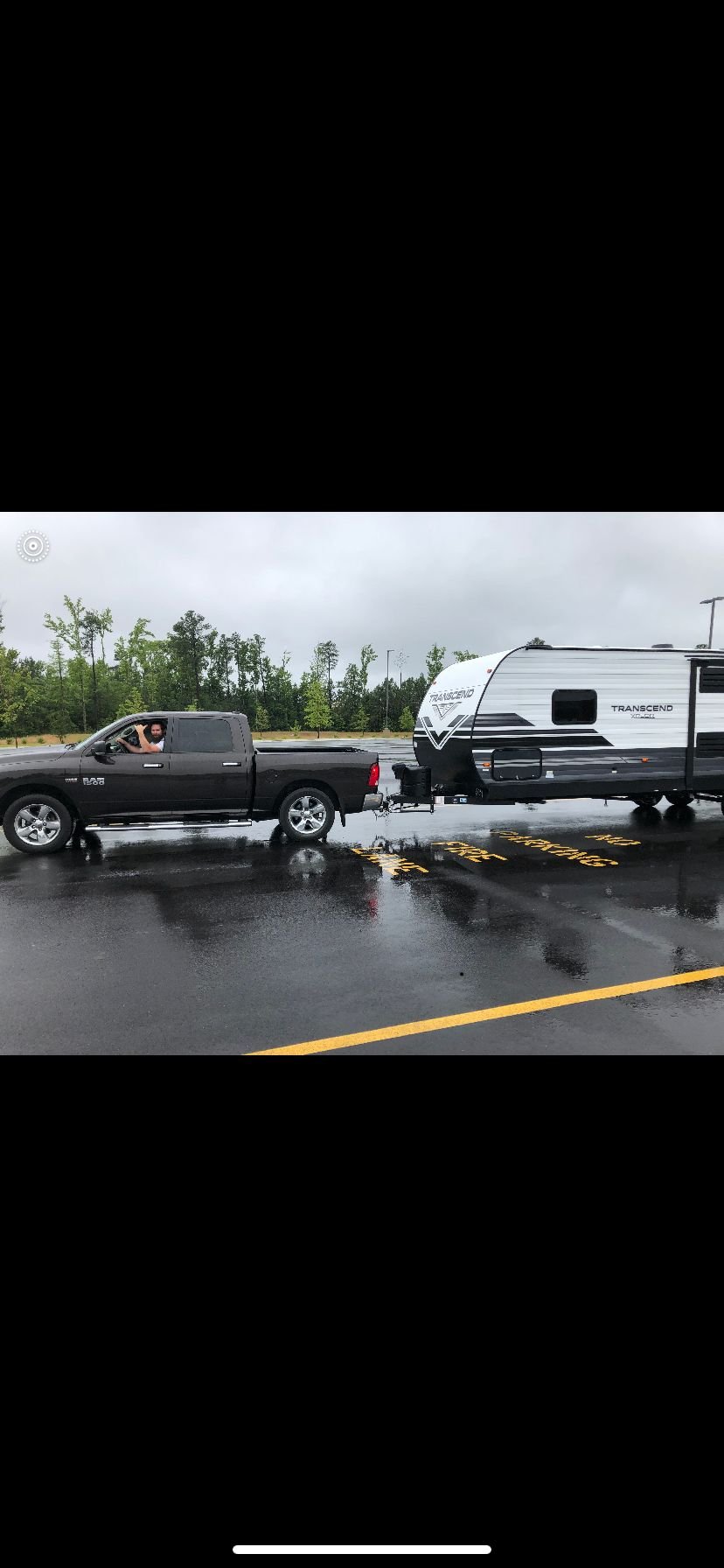

I'm new to the site and also pulling an RV. Before purchasing the RV, I made sure that the RV fit within my truck's (2017 BigHorn 5.7L V8, 3.21 Axle Crew Cab Short Bed) tow capacity; ~8600k. My question to all of you Ram Experts out there, what other numbers should I be looking at to be sure that my truck is performing within "normal" perimeters? RPMS, Transmission Heat, etc...

3.21 is a little steep for towing. It should handle it, just be sure to NOT use overdrive when running the rig. When you bob tail, drive it normal. You DO have a brake controller don't you? Equalizing hitch? It looks like you do in the picture, but I can't be sure.
