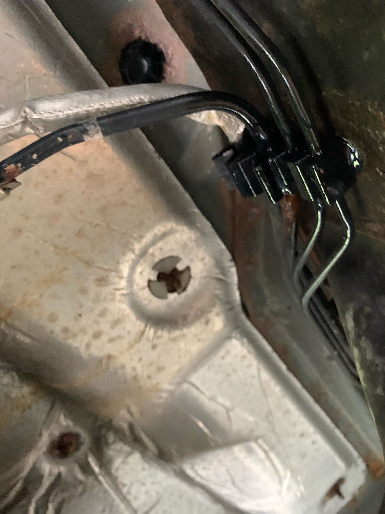

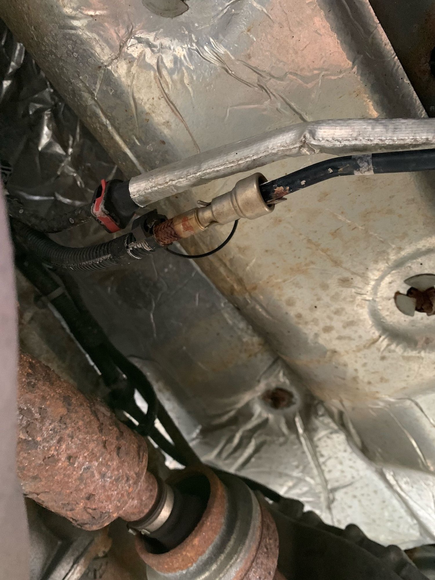

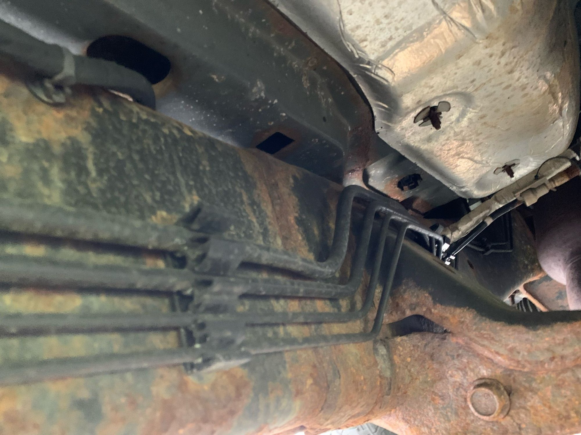

I started to smell gas and was having some prolonged cranking before morning starts. Found a leaking fuel line right underneath the driver seat area.

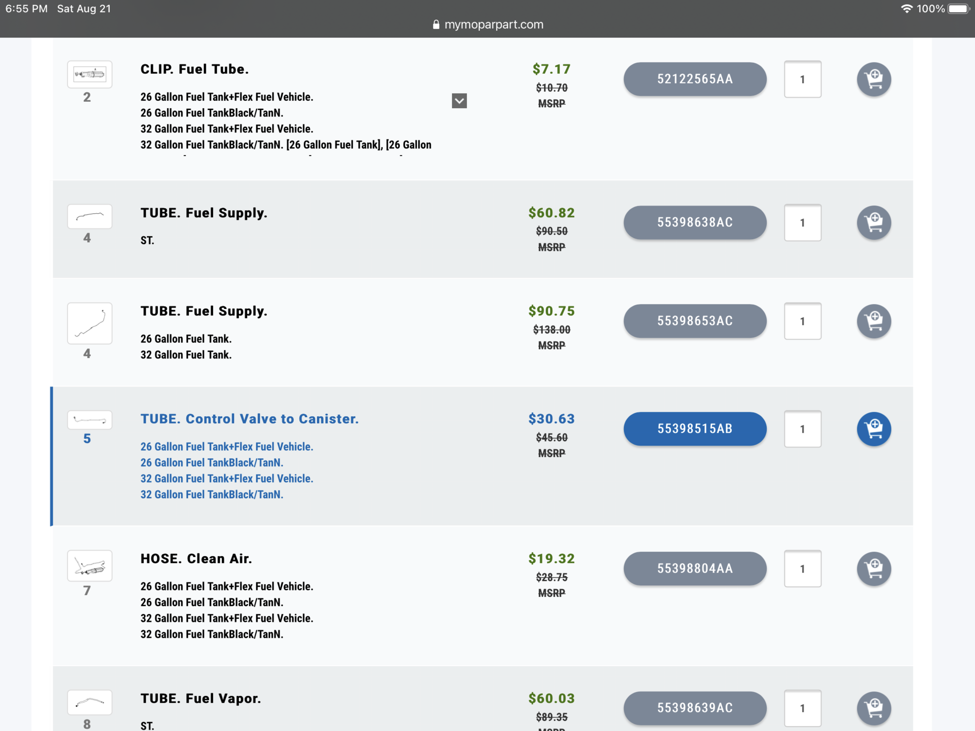

It looks like the fuel line snaps together in multiple sections, but I cannot determine from the Mopar OeM site which line is which. It’s a terrible diagram and it doesn’t seem to be laid out from tank to injectors, for example.
Is anyone familiar how to read the parts diagram?
There is a line that emerges from the fuel tank area… that line is fine… I need the one that snaps onto that one, clips onto the frame, and then snaps onto another line that runs up into the engine area. So assuming the fuel line is only 3 sections, I need the middle one.

The rear connection to the section from the tank
The connection to the line that goes up towards engine
Looking towards the front- the leak is just out of view on the right
The leak area

This one?

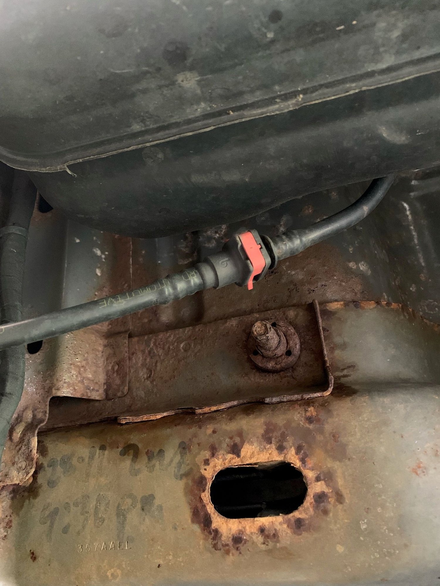

That hand drawing doesn’t look too close to it but who knows. I can’t find a real image of it to be sure.
I’m going to take it out and take a picture that might help.
