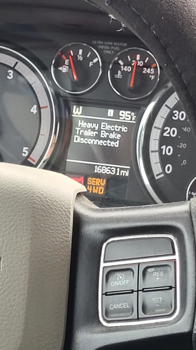

Exclamation truck says CF on controller and serv 4wd

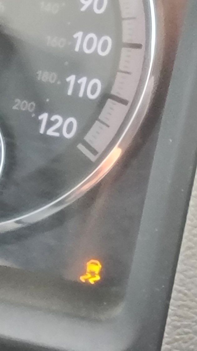

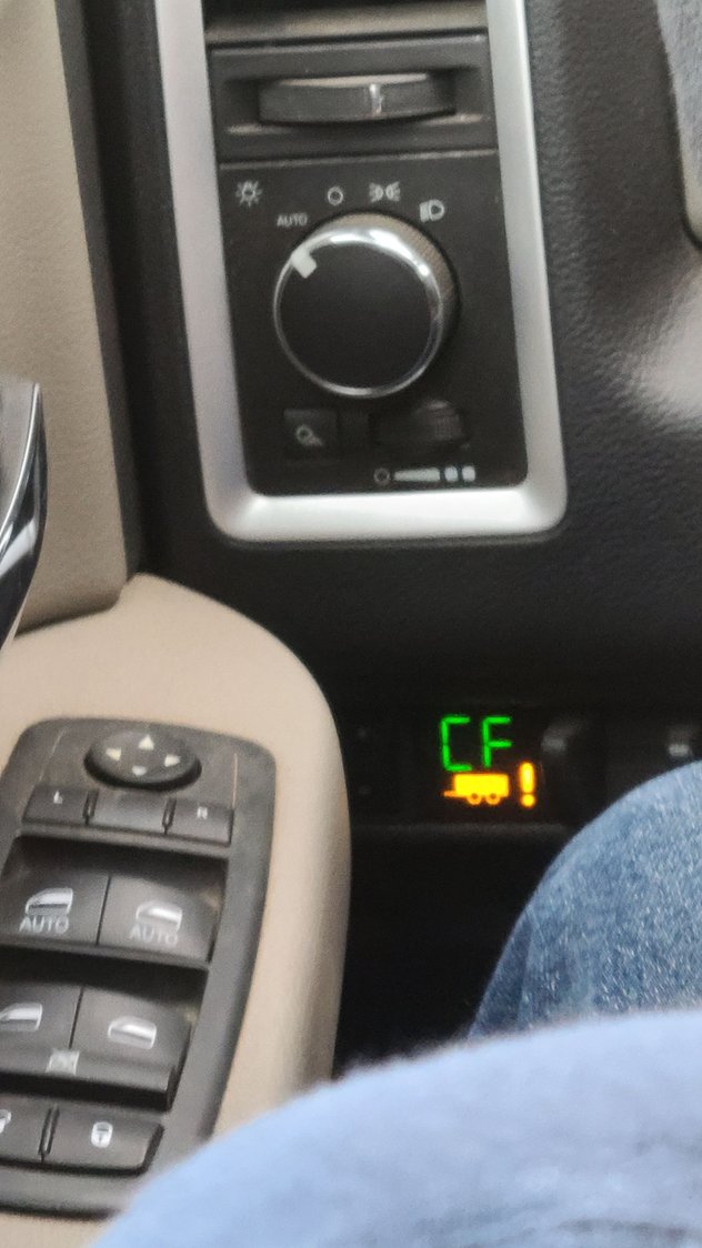

hello my truck has recently started doing this and im not sure where to start I spoke with my dealer they said no recalls for my truck and every once in a while my truck would throw a cf code on my trailer brake controller it is OEM and my display says heavy electric trailer brake disconnected and it says service 4wd but I am not connected to a trailer and when I do connect it everything seems fine I do not know if my trailer breaks actually engage cause I dont want to take it on the road without working breaks and I can engage those code my flooring it no crazy speeds but when I turn the truck off like the computer resets and my cruise control does not work and when i scan the car it has some abs codes also sometimes when i turn my key to let the element heat up for 30 sec i turn the key and the whole dash shuts off when i release the key the dash lights up so i would have to cycle key like 3 times take it out then retry and it will turn on i read while ago that my can bus is not working any help would be appreciated it wont let me upload a video of my truck display turning off when turning key

I think CF means Controller Failure. I would disconnect the controller and see what happens.

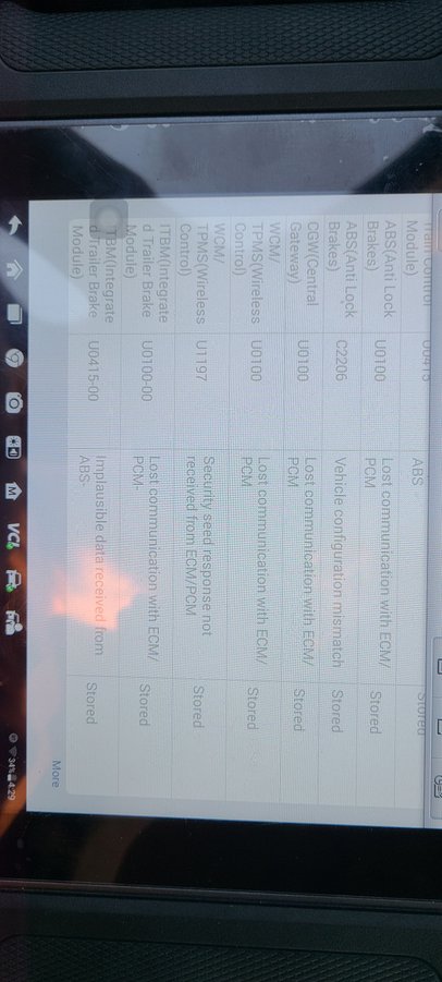

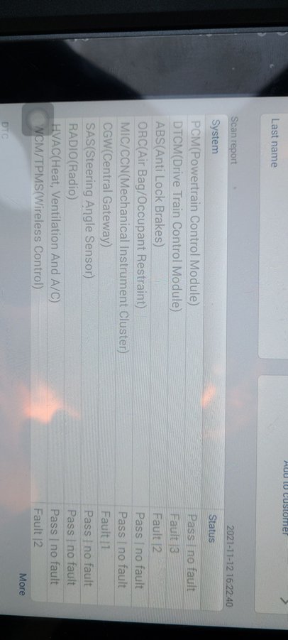

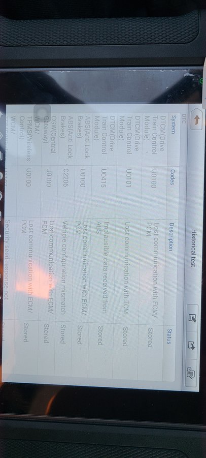

so today I tried to use 4x4 low and high they both seem to work but now I tried to engage that issue where my gauge go out and I had my scanner plugged in and ready to go i left the key for 20 sec and turned the key to crank and the dash went out so I held it in crank position and scanned the truck and still held the key in total for 1 minute and then the dash came on and the truck turned on like normal and I got the code to appear on my scanner but my dash did not light up with any code or issue I'm going to research the code put wanted to post the picture if you guys know anything how to fix

U0100 Code https://www.engine-codes.com/u0100.html#fix
U0101 Code https://www.engine-codes.com/u0101.html#fix
U0415 Code https://www.engine-codes.com/u0415.html#causes
C2206 https://www.engine-codes.com/c2206_dodge.html
U1197 https://www.engine-codes.com/u1197_dodge.html
some of the issue were showing the same code

All of those issues relate to a problem with the communications bus. My vision sucks, so I cant really read the screenshots of your scanner.

yeah i was doing some research and i was told to do a tipm/can bus reset so I will try it today for 24 hrs and see what happens but on the code description i kept seeing lost communications with ecm/pcm from the abs, itbm, and tpms so i assume my computer is jacked and is not receiving proper signals from those things and throwing everything off
