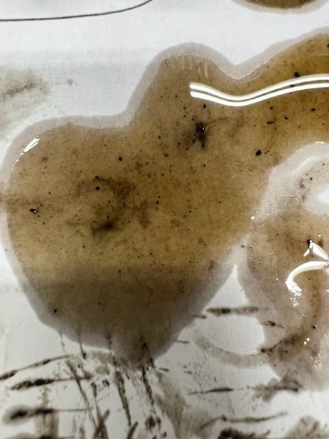

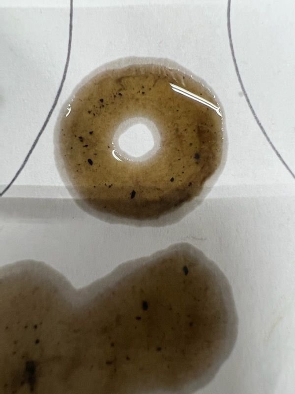

So, after a bunch of testing, the Cylinder 1 had 0 PSI of compression. When I pressurized the cylinder, It would leak out thru the intake at all positions while turning over the motor. Took the cylinder head back off and took it back to the shop where I bought it from. The machinist there told me it sounded like bad/Stuck lifters. So he checked everything on the cylinder head and everything tested perfect (Crap). I brought him the lifters also and he took them apart..... they were completely contaminated and had a bunch of crap in them. The lifters were replaced when I replaced the cam 6 months ago. I used AMS Racing V2 Lifters. So its looking like I need to replaced all the lifters and do a full engine flush per his recommendation. I really really don't want to pull the motor to flush everything so i wanted to get everyone's opinions. What should I do from here? I just want to be done with this. Attached are the pics of what the inside of the lifters looked like.

That's a fair bit of crap, and I am curious where it came from. Wonder if it is leftover ground up metal from the previous failure.... in which case, your best option is going to be completely going thru the engine, and having the block boiled out...... Might be easier to just replace the engine, and if there are any external coolers, flush them VERY thoroughly.
