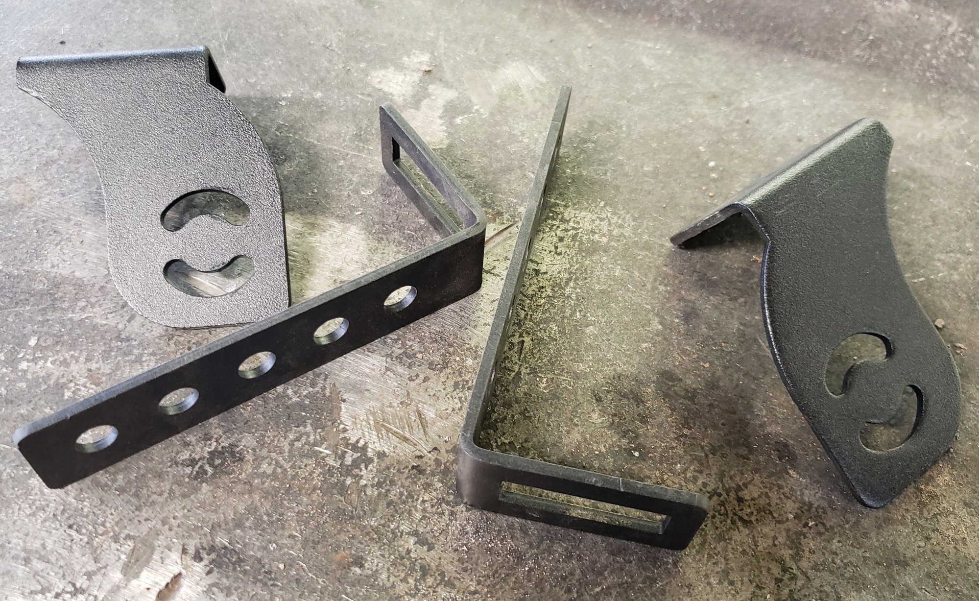

Basically started wirh this

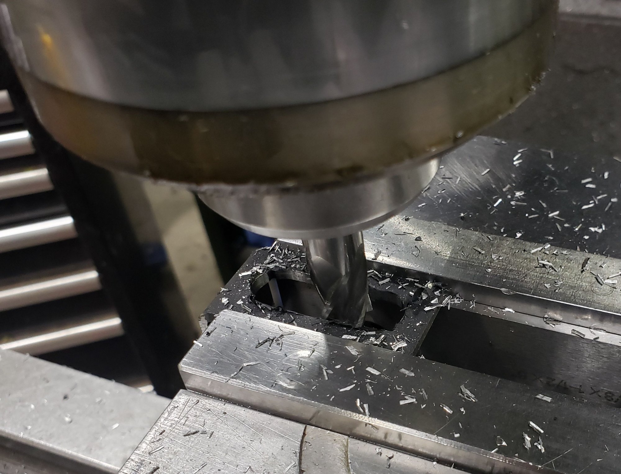

I think the slots were intended to fit the bumper bolts but they were .400" wide and the bumper bolts are M12 (~.470"). Opening up with a 1/2" em here

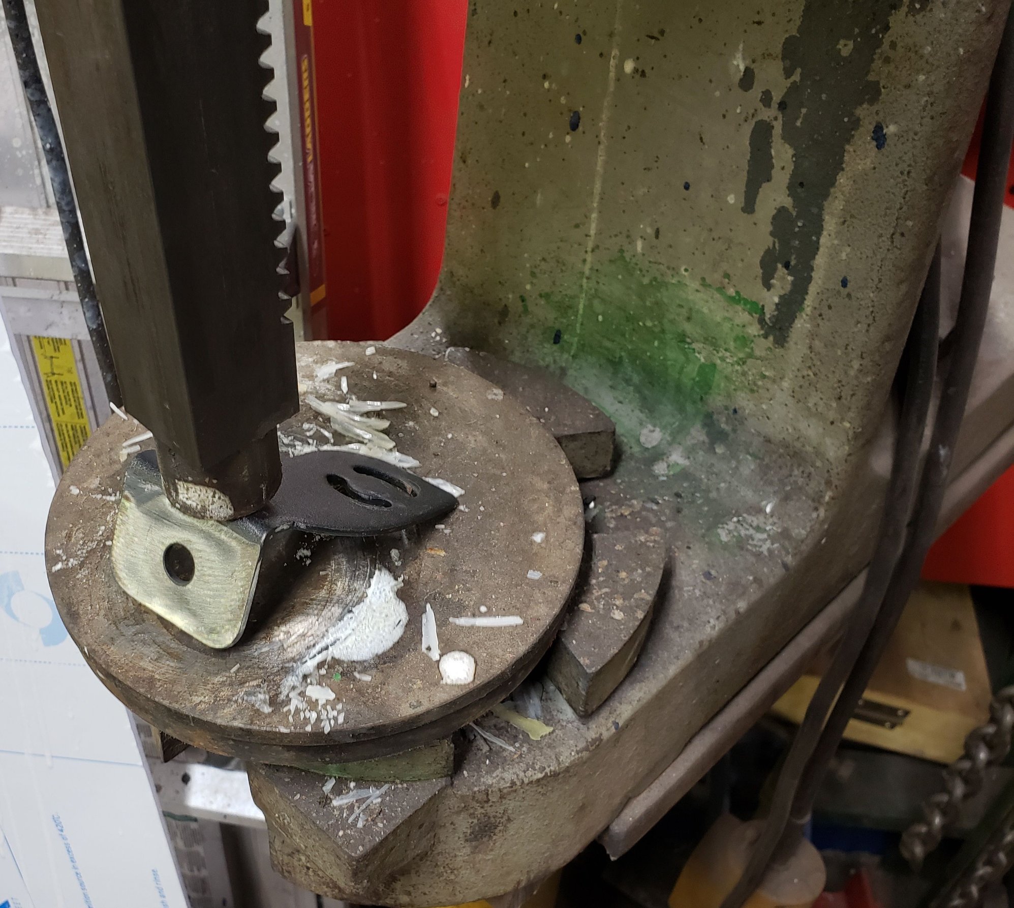

I wound up wanting the light higher than the brackets would allow so I actually flattened the bend in my arbor press then re-bent in a different location in my finger brake (not shown)

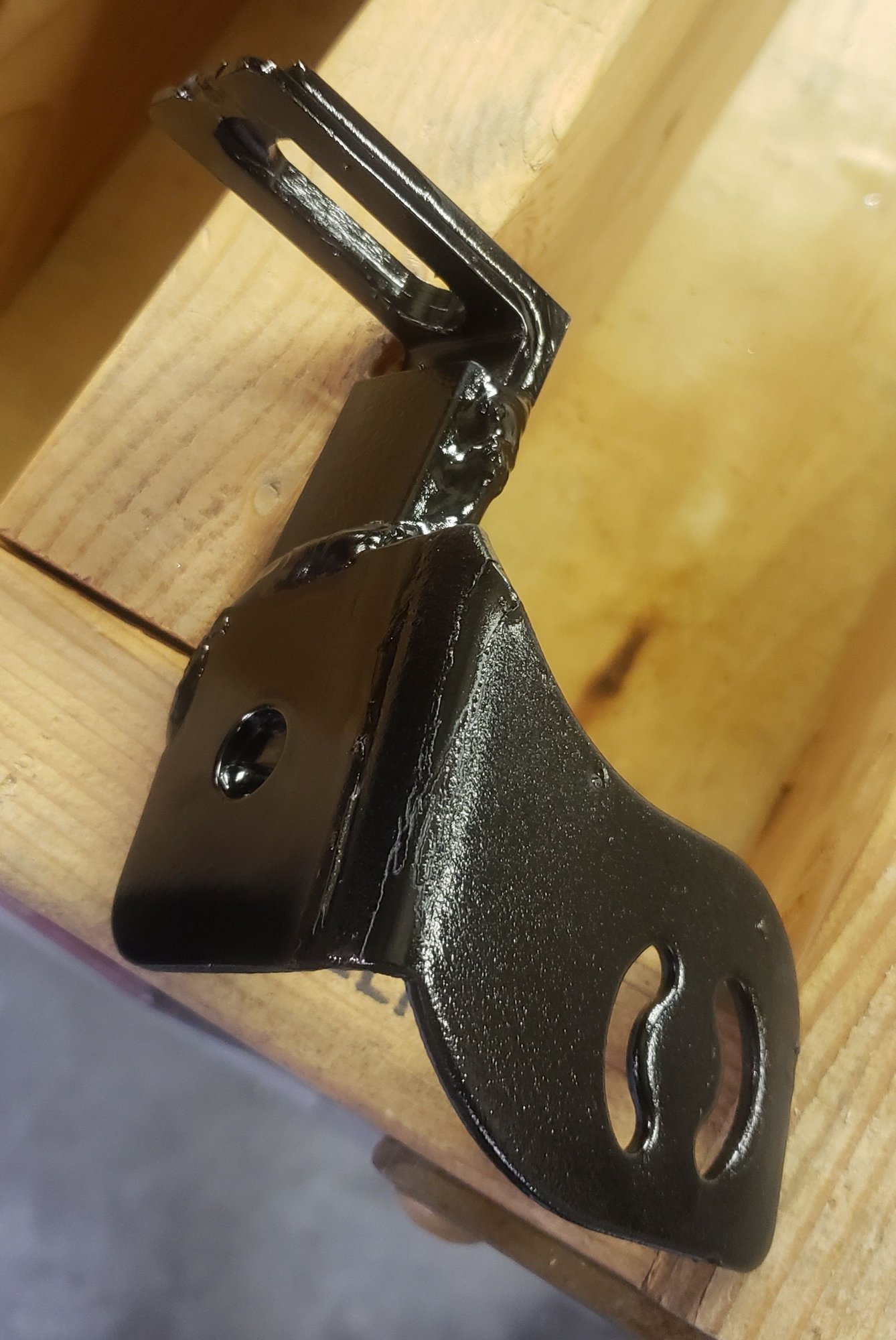

I finally wound up with this Frankenstein thing here. I added angle because the bracket was too flimsy.
