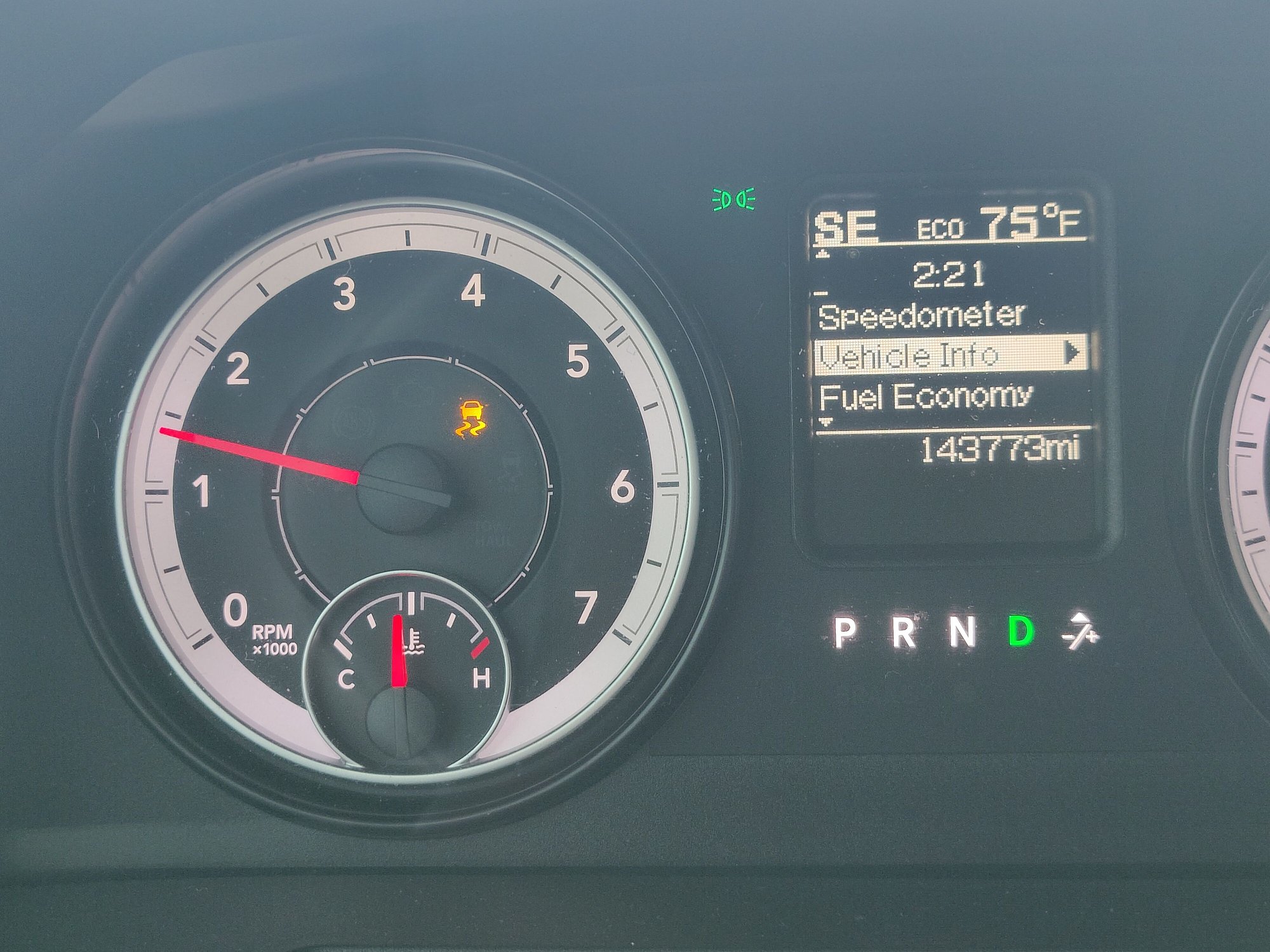

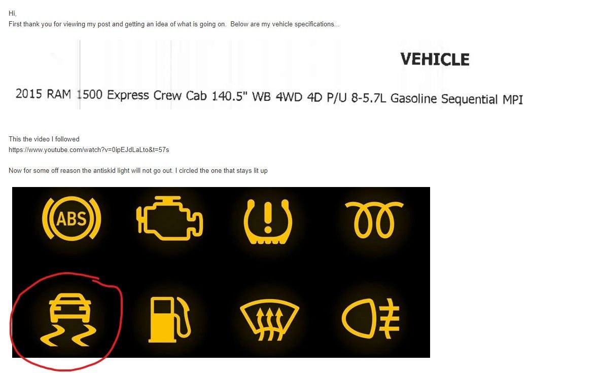

Hi,
I attached my issue within the screenshot. Thank you for taking the time to look it over.

Just a FYI -- this is the video I followed
The light will not go out now...do I need to reset it?

There will be an issue with a wheel speed sensor or other aspect of your stability control system. You should pull diagnostic codes for the system and diagnose rather than just attempting to clear the code or codes.
-Rod
Okay, I will pull the codes today and post them.
