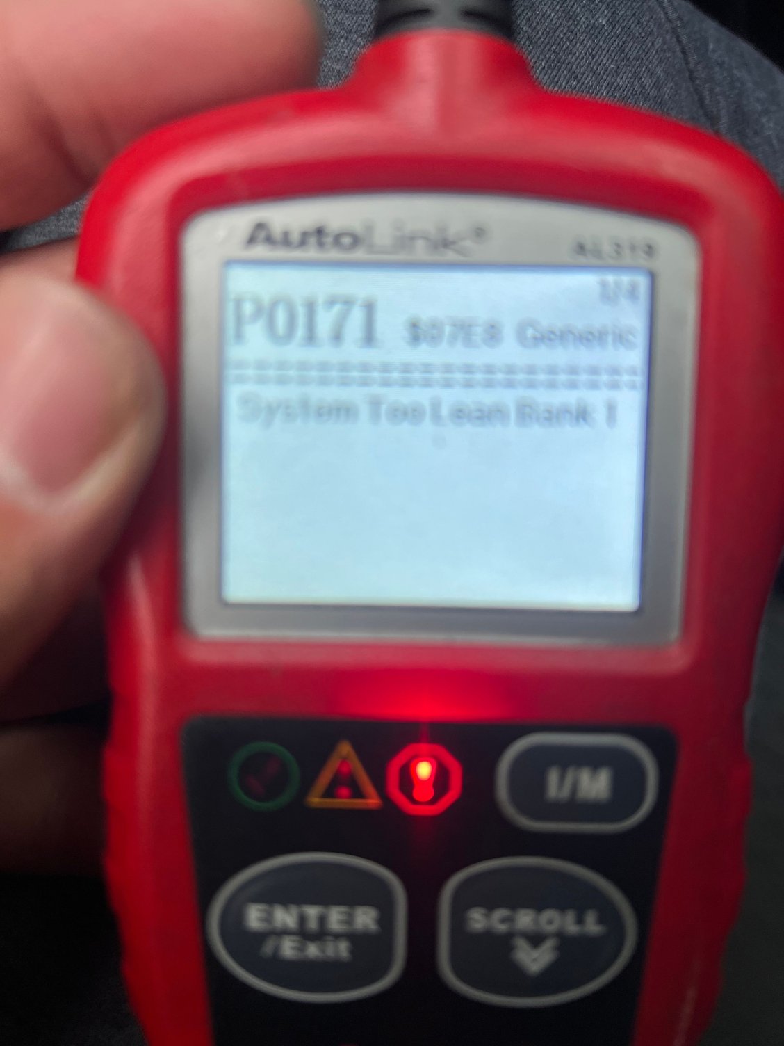

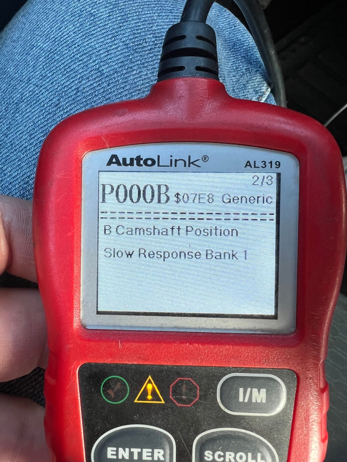

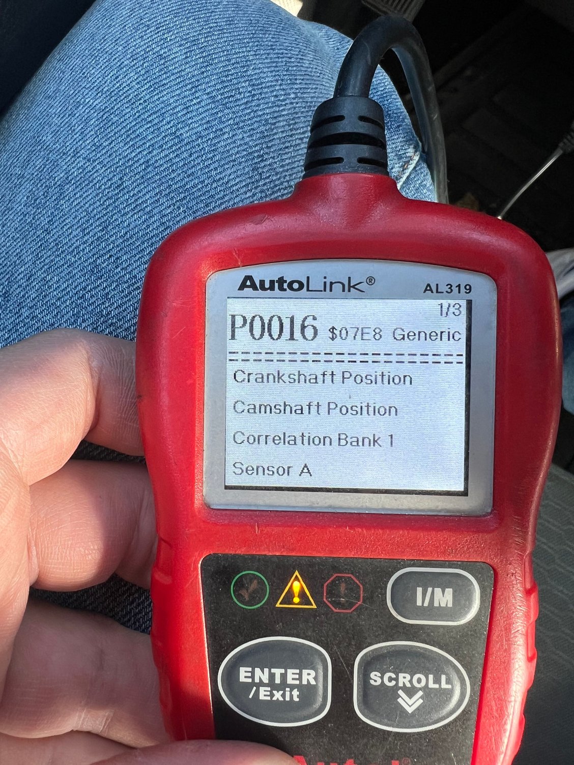

Hey everyone,
Hope someone could finally help me with this issue. I have a well maintained 2013 ram with the 5.7L 103k miles all stock, no tunes or modifications. Codes p000b, p0016 and p0171 came up after awhile of ownership. The truck goes un limp mode until codes are erased then everything goes back to normal until i shut down and turn on again and codes p000b and p0016 immediately come up(p0171 is occasional). Ive tried changing oil with 5w 20 mobile 1 synthetic and original oil filters multiple times, ive replaced vvt solenoid with oem one,spark plugs and coils, i have changed camshaft and crankshaft sensors, i have replaced the timing chain, guide and sprocket and i have checked all connectors to see if i find anything loose or broken to no avail. I have no clue what else to do and i have spent so much time and money already that im starting to give up. This is my last chance to see if any member could help me figure this out. I do not have any fancy scan tools i just have a bare basic scanner that could read and erase basic codes but same codes i pulled out are the same ones coming up on a snap on scanner.
​​​​​​​thank you!!!
