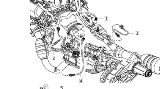

I've been chasing a rough idle and shutter at speed. I have the CEL and P219B. It began after I installed new exhaust manifolds and new O2 sensors. I am not sure that I have replaced with the correct sensor(s) on the passenger side (bank 2).
I found conflicting information about which O2 sensors to use. It seems to be dependent on model, transmission, 4wd vs 2wd, engine, cab and bed length. I used this information that shows 3 of the 4 as the same. The only one that is different is Bank 2 downstream.

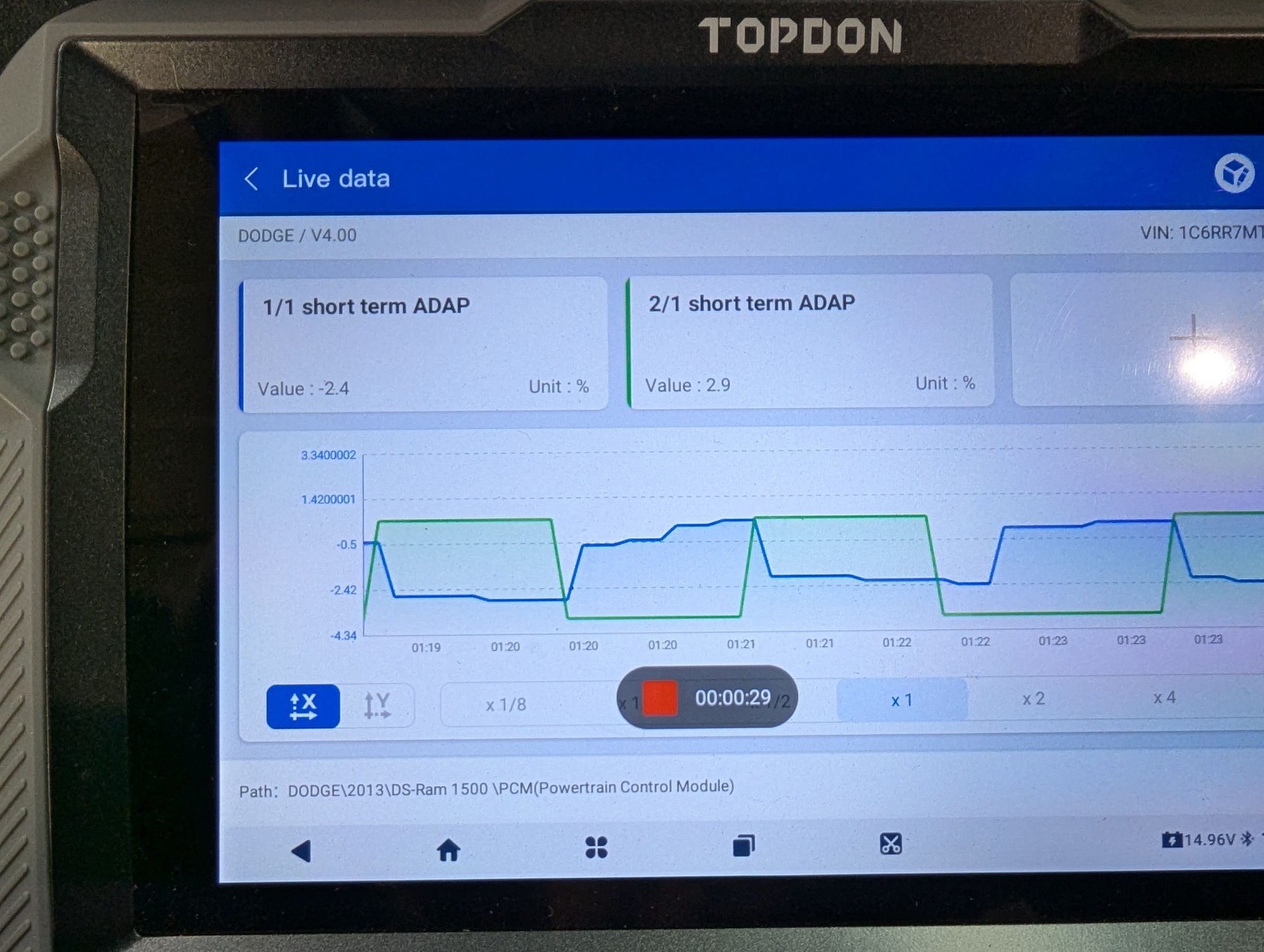

There are no cylinder misfires and no other codes. I have monitored the O2 voltages and they seem fine. The only thing that I believe is off is the ADAP short term.
It seems that way too much fuel is being dumped in on bank 2 but I don't know why. Any help would be appreciated. I do have a decent topdon diagnostic tool. I can get any info if needed. I would appreciate any help. I don't want to take this to my local Chrysler garage as they will just throw parts at it.

I have NTK sensors in. What doesn't make sense is that Mopar Parts Giant, Rock Auto, Oreilly, and Advance Auto all call out for 3 of the 4 sensors to be the same. It shows both sensors on bank 1 to use the 5149171AA and bank 2 to use the 5149171AA on the front and 68090640AA on the rear. That is the combination I have on my truck now. I do have some other sensors that I originally took off and a couple that I bought that I thought might be faulty. I have no idea how to tell them apart now. I'm thinking I'll try putting 5149171AA on front of both banks and 68090640AA on both rears.

Worth a shot..... Though, I suspect the only difference in parts numbers is the length of the pigtail, and maybe the style of connector...... An O2 sensor is an O2 sensor.
