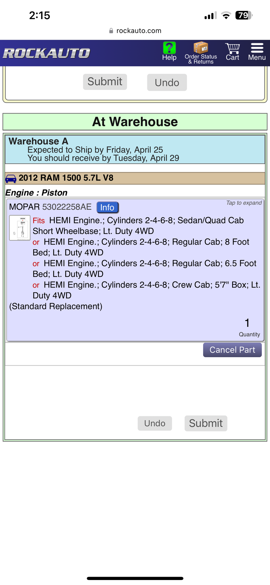

Recently motor started knocking and i was told lifters had to be replaced so I did. Ended up knocking after "lifter fix". Was later told I needed a new crankshaft, and one piston w/ rod. My question is if it's possible to even replace just one piston, or will I HAVE to replace all of them? I'm getting the piston from rockauto so it's oem.

Depending on how bad the crank is it may be able to be ground and all you will need is oversized bearings.
You mean this? Make sure you get the correct even or odd side.
